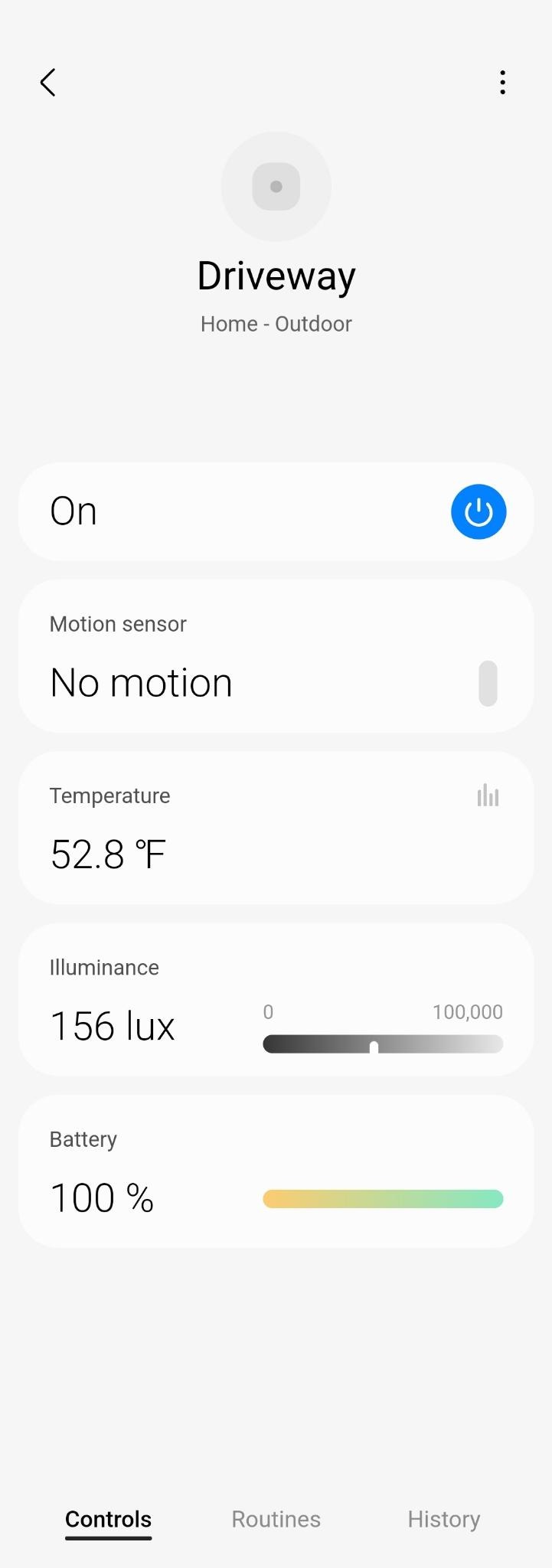

Sensor Device
Get motion, temp and light level updates for use in automations. Motion sensors can also be enabled/disabled.
