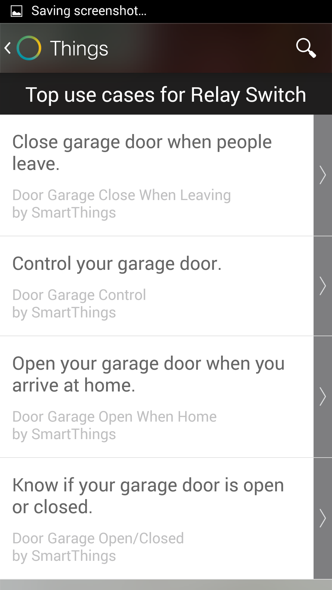

I’ve modified the ST default “Z-Wave Garage Door Opener” to better work with the “doors & locks” module. As far as I know, this would only be useful for the linear GD00Z device (and variants including the Iris opener.) This will allow you to select your garage door device as both the “open/close sensor” and the “garage door opener relay.” At that point, from within the “doors & locks” module, you can use “open and close it remotely” (and perhaps the other sub-modules that open/close the door.)
All this does is to add the “relay switch” and “momentary” capabilities to the type, stubs on()/off(), and defines push() to either open or close the door (depending on it’s current state.) It’s not a perfect implementation, as the “doors & locks” module might show the door as being “stopped” when that’s an invalid state of the Z-wave door opener.
To use: go to the ide, create a new device type, from code, copy this code in, save, publish->for me, then edit your garage door device to use this type (my z-wave garage door opener) instead of “z-wave garage door opener”

[/quote]This isn’t a smart app. It’s a replacement device type that allows the garage door device to be better handled in the “doors & locks” section of the mobile app. This theoretically enables to the following functionality of “doors & locks”: “Open and close it remotely”, “Open it when people arrive”, and “Close it when people leave.”

Thanks for this! I copy/pasted the code into a new Device Type and switched my Linear device over to that new device type, no problem. I went into the Doors & Locks dashboard app and edited the Garage Door entry, and was able to indicate that the Garage Door device is able to respond to open and close requests. So far so good. However, I still don’t have a shortcut to the Garage Door in the Shortcuts screen in the Doors & Locks dashboard app. Any thoughts on what I’m missing, here? Thanks again!
Once you’ve set up the “open and close it remotely” section in doors and locks, it should eventually show up. You might need to go into “edit door name and devices” to ensure that both the “open/close sensor” and the “garage door opener relay” are both configured.
It’s also possible that you’ll need to open and close the garage door from “things” at least once.
Obviously, I’m not entirely sure what it takes, but it does eventually show up. :smile:

Can someone help me through the process of getting this added. I’ve added the new device type code but not sure what I need to do from there. My Linear GD00Z-4 is currently setup and working as a Z-Wave Garage Door Opener but without the added functionality of your new code. So what do I need to do to switch it over? Do I need to delete the existing one first and start from scratch? or is there a better way. I’ve searched for the new device type on my phone but it never shows up.
When you go to ide.smartthings.com, and click on “my device types”, do you see an entry for the new device type? If so, also from ide.smarthings.com, click on “my devices” and you should see a list of all the actual “things” you have attached to your hub. From there, click on your existing garage door opener, then “edit” that, and change the “device type” to the newly added device type. After that’s saved, you should be good to go.
