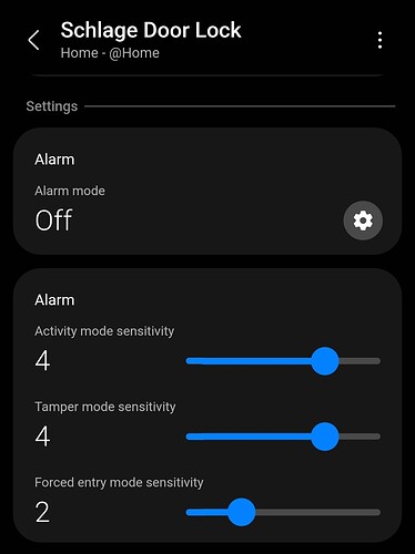

| Set Schlage Lock Alarm Mode to Tamper: | Edit the Schlage Lock Device in SmartThings. Change Alarm Mode to Tamper (adjust the Sensitivity to your liking). |
| NOTE THIS WILL ENABLE A LOUD AUDIBLE ALARM FROM WITHIN THE LOCK ITSELF. | |
| THE TAMPER ALERT WILL ONLY FIRE OFF WHEN THE DOOR IS LOCKED AND DOOR IS PUSHED OR LOCK IS TAMPERED | |
