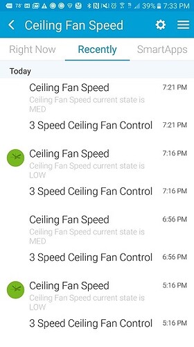

It looks like you have more than my one smartpp or rule fighting for control for the Living Room Fan? To test out my 3-Speed Fan Control (3SFC) smartapp you should temporarily disable or remove all the others trying to control your Living Room Fan. What product exactly are you using for your Living Room Fan and what device handler did you have for it? It looks like you may only have a switch that is on and off not 3-speed?
Here is what 3SFC produces on my mobile app and I had to remove my Rule Machine rules to not conflict. The name of my ceiling fan switch is Ceiling Fan Speed.
I using a Ge zwave fan controller and I’m using the handler that was in the link. It’s 3 speed, I’ve removed smartrules and reinstall the your smart app.

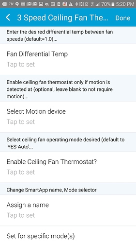

I installed and played with this yesterday, the temperatures rising works good, I really didn’t go through the temp dropping though. Another thing is when I try to add a motion sensor I get this error.
Sorry Daniel. can you let me know what version you loaded? It shows up on the user preferences at the bottom, right above the Assign a name. I made a bunch of little changes to clean it up before submitting it to SmartThings and I must have dinged it. I’m looking for the bug now and it will help speed it up if I know which version you got this error at.
It’s 1.0.20160515d
Thanks. OK, I think I found my typo error that caused your issue. It was like I thought when I was cleaning up the code I neglected a line. The IDE simulator didn’t flag it.
Go back to github link above and get the latest code from today,
Version: 1.0.20160516
