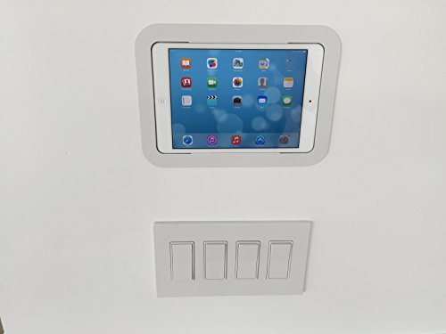

Wall mounted iPad=Expensive! There are many low price tablets out there that will fit the bill. Couple that with SmartTiles and you have a totally customizable button, switch or whatever controller. You will just have to be a little creative on how you mount it for aesthetics.
I recently purchased 4 Fire Tablets 7" for under $100.
YMMV!
Yeah, I have a couple of the kids old Ipad mini’s i can use, but my research on wall mounting led me to:
  • Very expensive (Iport, Iwalldock)
  • Questionable and cheap brackets
  • Custom drywall framing and mounting work.
