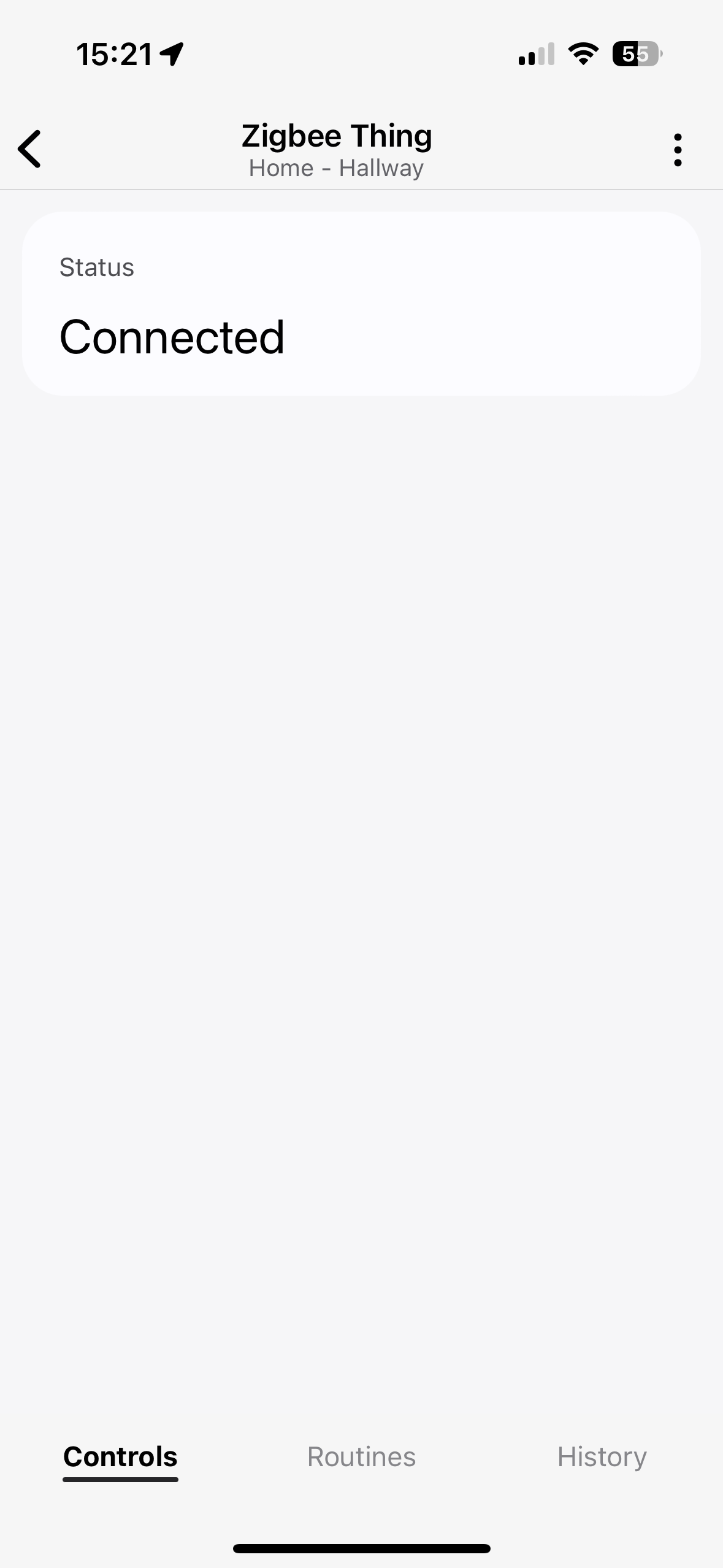

@jkp @JDRoberts thank you both for your replies, I think I am slowly getting there. I’ve managed to re-add most of my devices and they look to be working, just need to figure out the motion sensor. It adds its self as a default Zigbee Sensor with no actions, I recall in the past I had to tell it which driver to use, but when I select “Driver” I get a No Results Found. I’m frantically looking to see if I made a note of which driver I used in the past to get the motion working, however even if I find it I can’t see how I would apply it. I’ve also tried searching using the magnifying glass and selecting devices from there, it still re-adds as a Zigbee Thing.
This means that the platform was unable to find a matching fingerprint for the device. So it just added it as a generic “thing.”
So start by going to the advanced page and see what fingerprint it’s using. The following FAQ explains that process and has the link to the advanced page.
FAQ: Manufacturer/Model Shows All Zeroes
And again, once you’ve found an edge driver that you want to use, here’s the FAQ on how to change to it. But you can only change to an edge driver that matches the fingerprint for your device, so that’s why the first thing is to find out what the fingerprint is.
FAQ: How to change to a different edge driver
Ok, so I understand what you are saying and I’ve read both articles. I’ve also located my device fingerprint:
The bit I don’t understand is it refers to a ‘channel’ page or an invite to channel link. I’m guessing I have to search for a channel that covers my hardware fingerprint? I think I found a driver on GitHub but am unsure how to get that driver on to my device:
[EDIT] I have found the Channel ink on the GitHub page, I will do some more reading, thank you for your time. [/EDIT]

Thanks, I’ve marked that as the solution, just to be clear for anyone else following in my footsteps later. I joined the Channel by Enrolling and then selected Install for the driver I wanted. After a short period it then appeared in the Drivers Section of my Device and I have been able to switch to it and get the thing working.
I guess the main change in the new way of doing things is before you could pick almost any driver and try it, where as now you can only see drivers which match your devices fingerprint, which I guess is better in a way but the process of getting more drivers to appear may not be immediately obvious.
Thank you for the help.
