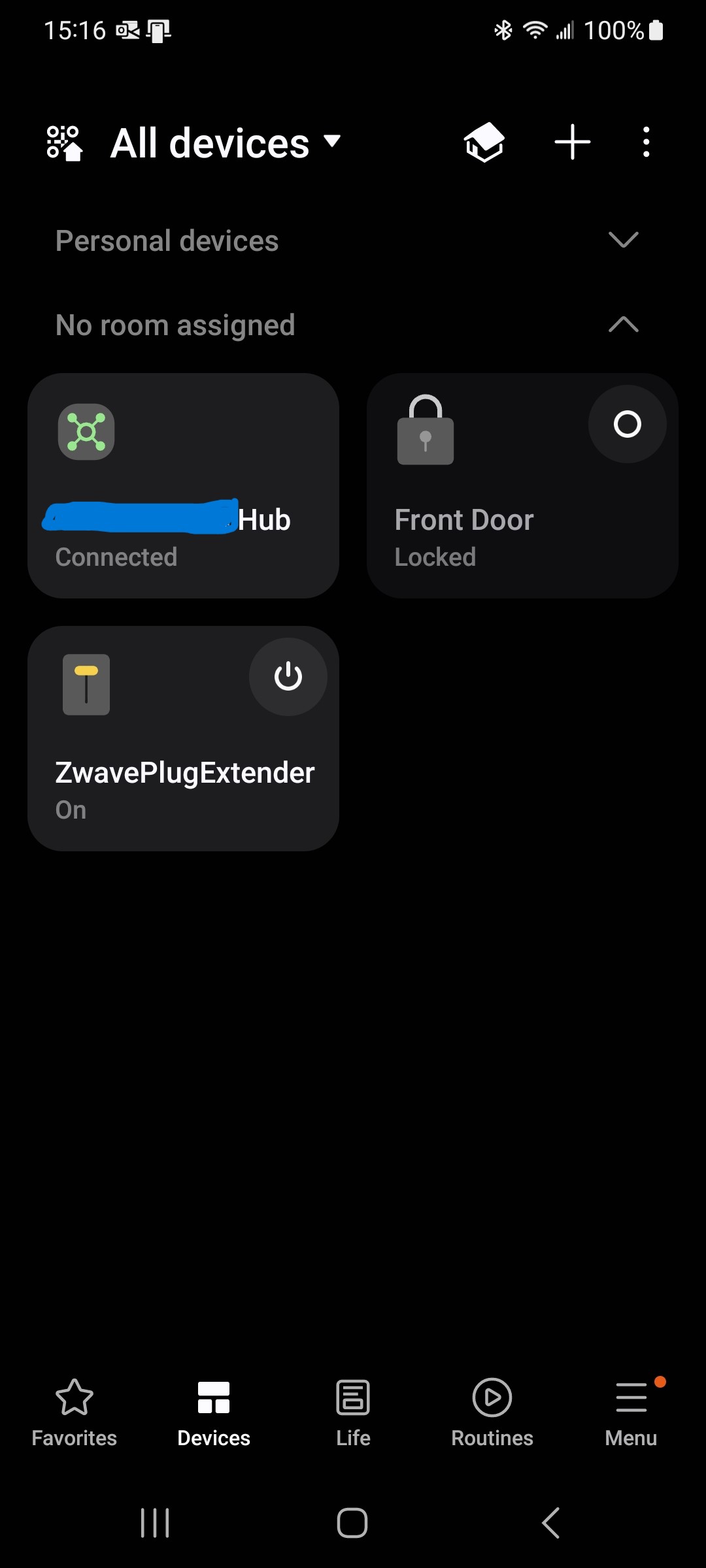

I only have 2 devices, a lock and an outlet. I failed at pairing a different outlet. Unfortunately I don’t see any unknown/leftover devices in the app or on my.smartthings.com

That is the issue for me, I can’t figure out where the Unknown Device is coming from. This is what I see in the App:
and this is what I see when I do a Z-Wave repair:
Just not sure where to look to remove the Unknown Device.
