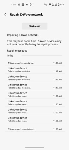

Just did another z wave repair. The process finished I was able to see the message Z-wave network repair finished.
Only one Unknown Device found (not 3 as before). Waiting for more instructions…

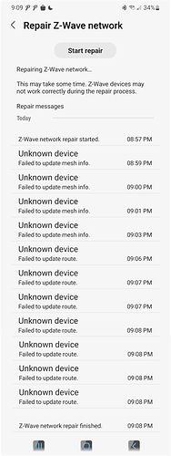

Hello, when trying to repair the network, it seems to get stuck on either 1 Unknown device for hours, or reports many unknown devices and then fails.

Hi @RBoy thanks for your reply. I actually followed your advice about the repeater already, following another thread a few months back. Unfortunately I am still having the same issues, and the z-wave repair is showing all these “Unknown device” with failures to “update mesh info” and failure to “update route”
Unknown devices are likely ghost devices, unless there is a bug in the firmware where it can’t map the zwave id with the corresponding device and ghost devices can definitely interfere with the mesh routing and stability. @mtilchen @AlejandroPadilla
