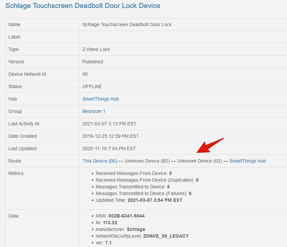

Yes, in the device IDE I see it shows the route information, please see below screenshot image link.
So in this specific example, I deleted Unknown Device (B2) ↔ Unknown Device (02) and then tried running the Z-Wave Repair but then coming back to this screen again it would show different unknown devices like (AF) and (04).
