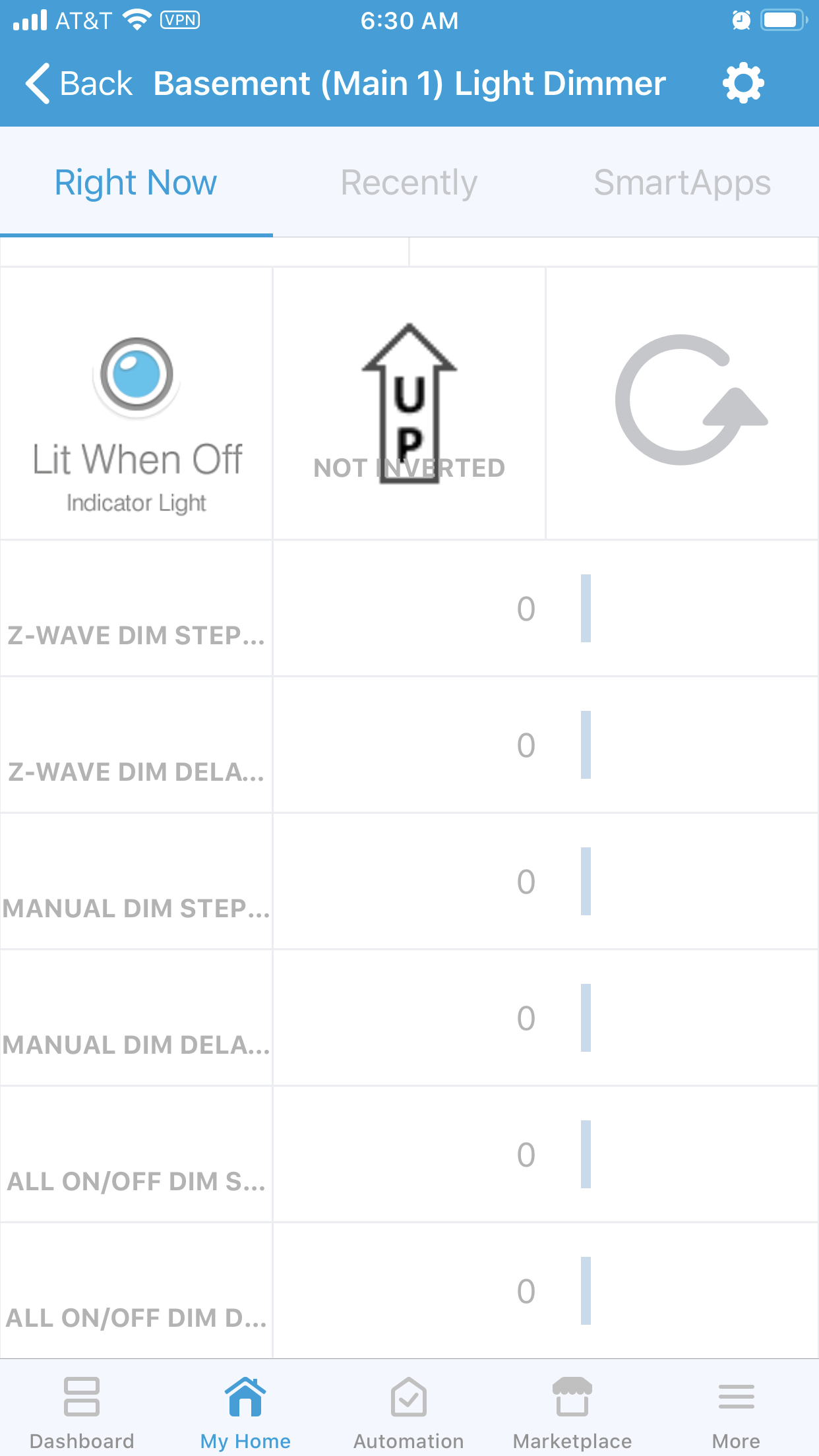

prod:4944 model:3235 ver:5.54
This is the quick fit, simple wire version.
The DTH doesn’t seem to be able to pull in any of the settings and the double tap feature is not working.
I have attached a screenshot of the setting just being blank. Everyone’s help is greatly appreciated!
Did you select your device in smartthings IDE and change its device handler to this one?
Are you trying to use the double tap in webcore? The double tap up or down are recognized as a separate button and not part of the switch that is why you have to add these to webcore even tough your switch may be added
