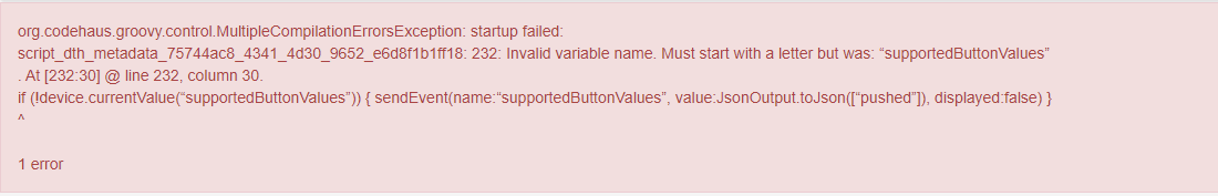

I get this error:
// parse events into attributes
    log.debug "description: $description"
    def result = null
    def cmd = zwave.parse(description, [0x20: 1, 0x25: 1, 0x26: 3, 0x56: 1, 0x70: 2, 0x72: 2, 0x85: 2])
    if (cmd) {
        result = zwaveEvent(cmd)
        log.debug "Parsed ${cmd} to ${result.inspect()}"
    } else {
        log.debug "Non-parsed event: ${description}"
    if (!device.currentValue(“supportedButtonValues”)) { sendEvent(name:“supportedButtonValues”, value:JsonOutput.toJson([“pushed”]), displayed:false) }
    result
edit: It didn’t like my copy/pasted quotes, had to re-type them:
if (!device.currentValue("supportedButtonValues")) {
    sendEvent(name:"supportedButtonValues", value:JsonOutput.toJson(["pushed"]), displayed:false)
