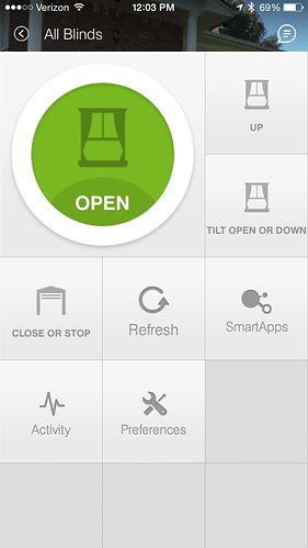

  1. Create the Somfy zRTSII Device Controller Device Type - Courtesy of @chriswood1001 (Chris’s Device Type)
  2. Create the Somfy zWave Blinds Device Type - Courtesy of @Ashwin (@ashwin’s code) . I modified this code to my liking by customizing the tile button icons and titles, as well as I had to flip flop the open/close statuses. There are a few device types floating around in the original thread, and the one that works best might vary, so try them all out.
  3. Plug in the zWave RTSII Module into an outlet and follow the instructions to program your zWave Controller and blinds to your Smartthings controller (Manual). For the channels (Virtual Node), in the ST app, you do Connect New Device, and then on the zWave RTS Controller, you add your virtual nodes. I had 5 virtual nodes, 4 blinds plus the "All Blinds: channel, They correspond to how my Telis remote is programmed. In my case, I now have 6 “things” show up (5 Blinds Channels and the controller). Below is the All Blinds channel:
  1. Now that your blinds are fully controllable in SmartThings, the possibilities are endless. In my case:
a) I setup 3 Hello Home actions, which are pictured in the video below:
Tilt Blinds Closed, (This is what was programmed to the My button on my Telis Remote) - Set to turn the All Blinds Switch On and Dim at 50%
Tilt Blinds Open Or Bring them Down (if they are raised up) - Set to turn the All Blinds Switch On and Dim at 20%
Raise Blinds Up - Set to turn the All Blinds Switch on and Dim at 100%
b) I then setup 3 virtual switches (using the built in SmartThings Momentary On/Off switches) and published 3 smart apps (Big Switch for Hello Home Phrases) which program the Virtual Switches to the Hello Home action. The virtual switches allow me to easily press a button in the ST app to initiate the 3 actions I mostly use and utilize them easily in @625alex’s Action Dashboard:
c) I setup my Hello home phrases to Open/Close blinds at sleep time, sunrise, when kids are napping, etc. It works out well.
