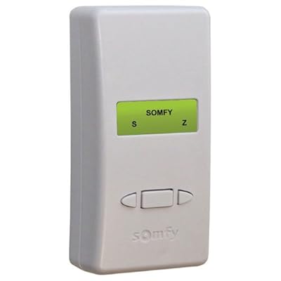

This device handler needs a zwave to RFS like this one?
It depends on your shades. The new Bali and Graber blinds don’t require it and are zwave native.
I understand, but if I have a somfy RTS for my horizontal blinds, how do I connect the RTS to the zwave?
Using that wall module I posted above?
You said you use with your somfy blinds…
I think that device pairs directly with SmartThings. There is another thread about it, I don’t have one.
I’m reading the other topic. Thanks. =)
But i’m preety sure you said you tested with a somfy controller.
I did. I meant Somfy blinds not the Garber. Mine are the new ones, not the ones that require that device.
Oh, I see.
Do you know if there’s a stand alone motor from Somfy (to exchange mine) that works like yours?
But going back to the app.
Does all this functions work also with the ZRTSI or only with these brand new blinds that come with zwave?
