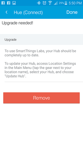

Ok, for reasons I will not go into here I took my entire system down last night. I disconnected and deleted everything.
I’m trying to connect my Phillips veer one hub to ST and I keep getting the screen below.
The hue hub says it’s up to date. I reset it to factory settings and tried to force an update.
As you can see the bridge is working. It find and controls my Phillips lights.
What now?

The joy of the cloud is that they can break stuff without even updating your hub. This is a known issue and they are working on it. Send your issue to support and they will add you to the list and notify you when it’s fixed.
Basically all the connect apps check the firmware version in the same way and they did something on the server side to break that call

Yep, this has been discussed in several Topics already:
Continuing the discussion from Removed Hue Bridge, now cannot re-add it :
Looks like hasAllHubsOver(“000.011.00603”) is not working when version is 000.013.00013.
On my side, stopped working:
Hue Connect (even my fork)
Netatmo
I think your hasAllHubsOver function didn’t get through the QA correctly
Tonight I got 3 new hue bulbs, and added them to my bridge without issue, but they would not show up at all in smartthings. After playing around with it I ended up removing my Bridge, and now I cannot re-add the bridge. When I try to connect to a new philips bulb or open the Hue smartapp, it says that my Hub needs to be updated. As far as I can tell my hub is up to date, I have tried rebooting it several times and pressing the red button. Here is what it shows me…
http://imgur.com/pZk4OLZ
There is no option to update as described.

go here and it will fix it.
I want to start this with a thanks to @diehllane for pointing me in the right direction to get this fixed.
Also thanks to @jjslegacy for coming up with the fix.
I’m just passing on the info. @chrisjohnson00 this is what you need.
This is works wonderfully for my Phillips Hue Hub. I have no idea about any others, but this should work for them as well.
In the Phillips Hue connect app (if you still have it installed and you’re getting the “Hub needs updating” warning, do this:
Change Line 696-699 (in the code below) to look like this:
private Boolean canInstallLabs() {
//return hasAllHubsOver(“000.011.00603”)
return true
If you have uninstalled the app for whatever reason, Here is the modified code. Just go into the API and create a new smartapp from code. Use this code:
