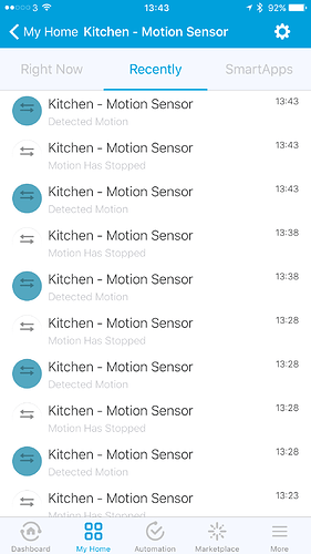

My kitchen motion sensor seemed to be stuck for hours in motion so I finally replaced the battery with another brand new one though it was showing 89%
Now misfires are back in full on misbehaviour
