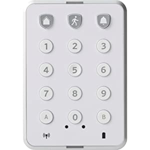

    1. Install a keypad depending on your preference and what additional features you need from the keypad (such as a chimes, alarms, form factor etc). Here are some options with pairing instructions:
    2. Program user codes in the keypad using any of these lock management apps:

    2. Install a keypad depending on your preference and what additional features you need from the keypad (such as a chimes, alarms, form factor etc). Here are some options with pairing instructions:
    3. Program user codes in the keypad using any of these lock management apps:

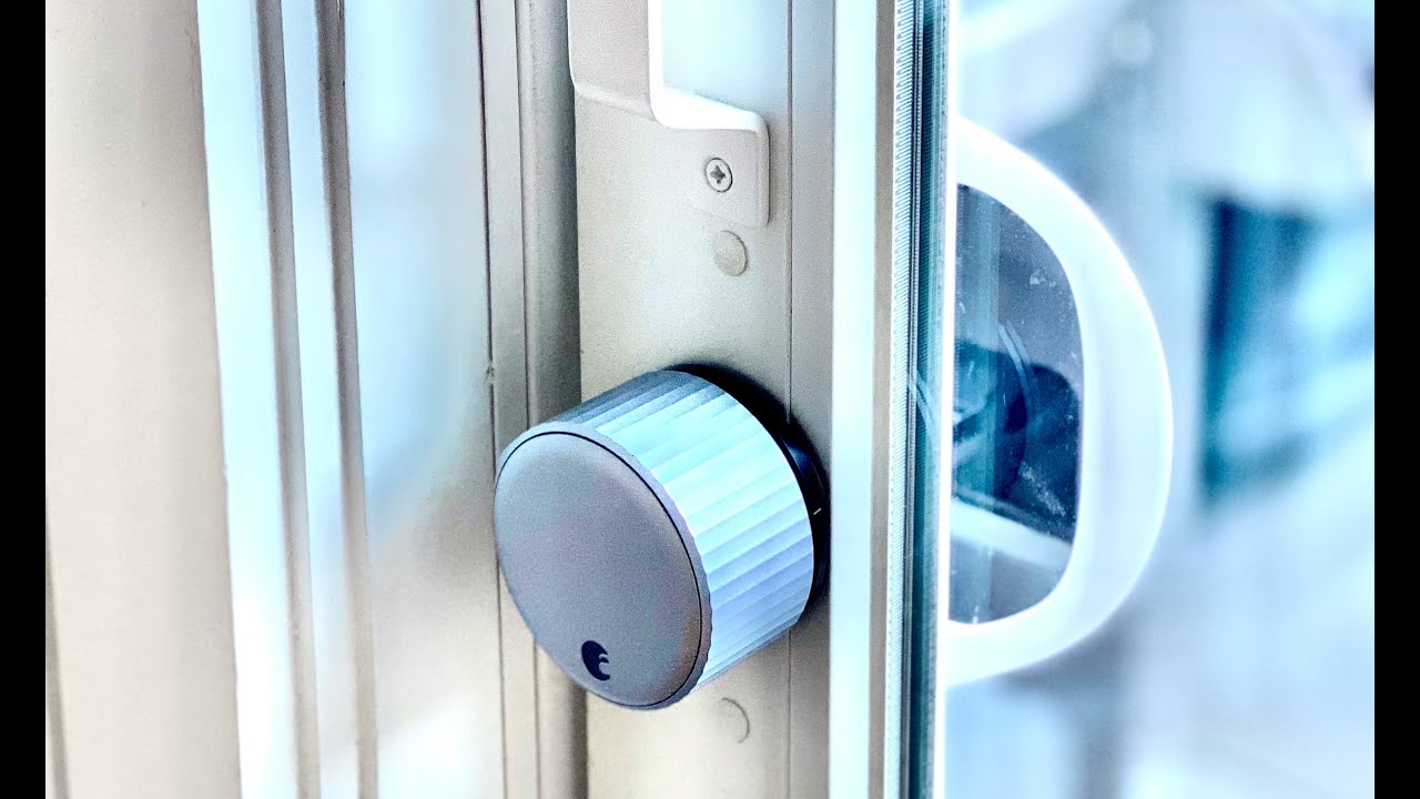

Retrofitting an August Pro or Nuki on the Sliding Door Mechanism
  • Lock/Unlock
    To lock (open) and unlock (close) this sliding door from SmartThing you will need a use a turn lock that can integrate with SmartThings such as:
  • Open/Close
    You can buy a simple open/close contact sensor to mount on your door to check the status of the door. You can choose from various ZigBee and Z-Wave contact sensors such as:
  • Programming Users
    • August cannot be programmed through SmartThings. May be programmable with external keypads from August and the August app
    • Nuki cannot be programmed through SmartThings. May be programmable with external keypads from Nuki and the Nuki app

I am considering this too. August have some locks on sale.
I looked around a bit, hoping to find one to experiment with, but they are still a little pricey for me at the moment.
