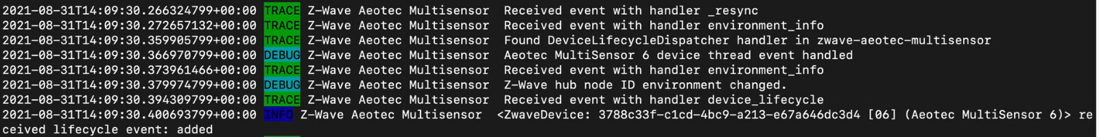

- From a computer on the same local network as your hub, open a new terminal window and run the command to get the logs from all the installed drivers.
smartthings edge:drivers:logcat

Keep the terminal view open until the βinfoChangedβ lifecycle event is received and the driver starts getting the REPORT commands from the device.
Example Output
β
β
If your Device paired correctly and the Driver was applied, you should not see any errors in the logs. You can validate this by opening the SmartThings app and controlling and/or viewing all of the devices Capabilities (e.g., motion or change the temperature).
