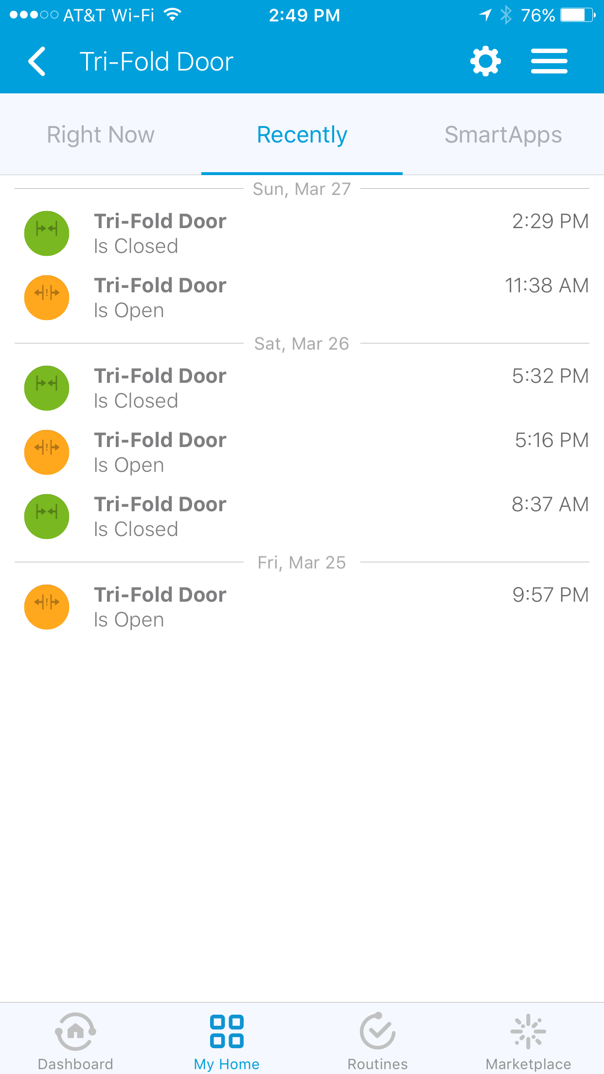

Sensor says it's open, but it's actually closed. Anyway to fix?

Says that it is Open:
No Activity:
But when I refresh it reports it’s true state, closed:

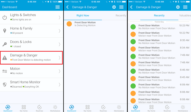

This is an ongoing issue I have been experiencing since January 2016. I have saved down 23 instances where this occurred since this issue really began to bug me earlier this year.
It appears more often than not the dashboard status does not report the true state of the device for my Multi Sensor and Motion Sensor (both ST branded) but I have occasionally seen the issue with lights also not reflecting status.
Example: Multi Sensor - Shows open but its closed.
Example: Motion Sensor - Shows motion but there is none.
Example: Lights - Shows some on but they are all off.
