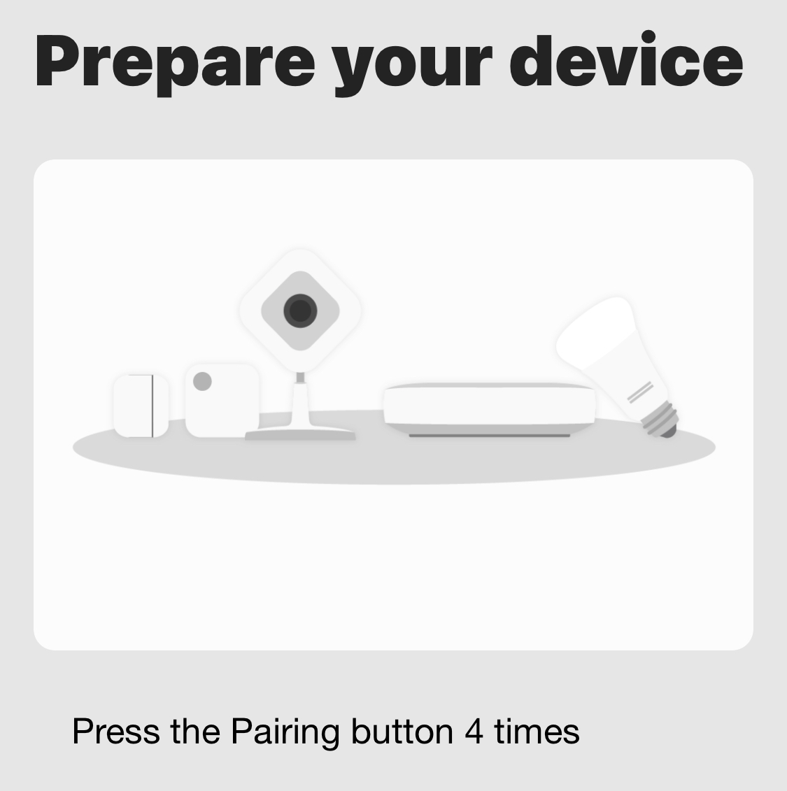

Strange that in the Android app many are listed as ‘Hub Required’, while in iOS if I tap Add Device->Partner devices → IKEA I see
The pairing is then shown, depending on which device
BTW the Rodret is not shown.
The listing where you see ‘Hub required’ is the ‘Supported devices’ page. In the Android app you get that as ‘View supported devices’ via the options menu on the ‘Add device’ page (or from ‘Supported devices’ on the app ‘Menu’ page). It is just a listing, it is not part of the onboarding process.
