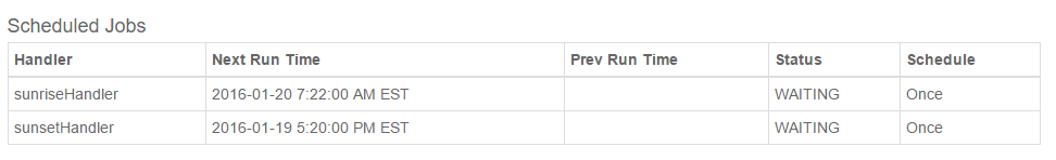

looks like even though the firmware has been updated something didn’t work right… this Is in my logs for hub events
please advise
or should I open a support ticket…
