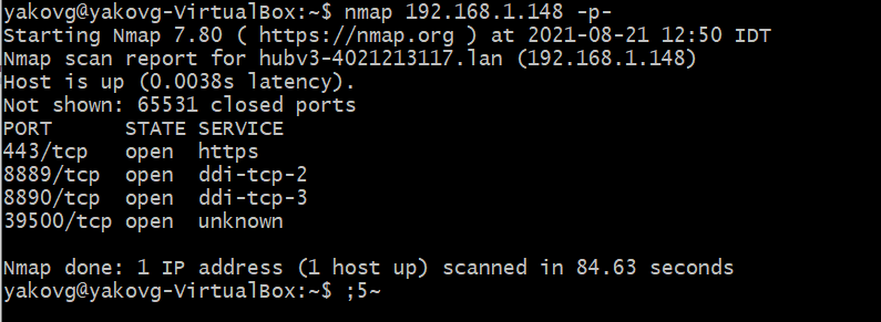

Thanks for your replay.
You mean to run nmap to see all open ports on the hub?
Are you suggesting that the logger server might be running on different port?
Did I get you right?

My guess is either the hub needs to be configured somehow, perhaps enter a developer mode or the logging service inside the hub crashes for some reason.
Hub reset did not do any good, so it is probably related to specific hub configuration
