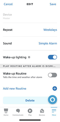

You need to make sure that you’ve linked Smartthings to Alexa as a skill. Alexa will scan Smartthings for devices…This will probably work with other devices too that are not on Smartthings.
In the Alexa App, create an alarm and on my app I can see a section for Wake-up lighting.
It’s part of Alexa routines.
It’s in some countries, but not all.
Alexa support could tell you if it’s available where you live.
Thank you very much for your detail answer. Unfortunately that option is not available in my country. :frowning:
It’s not, thank you anyway.
