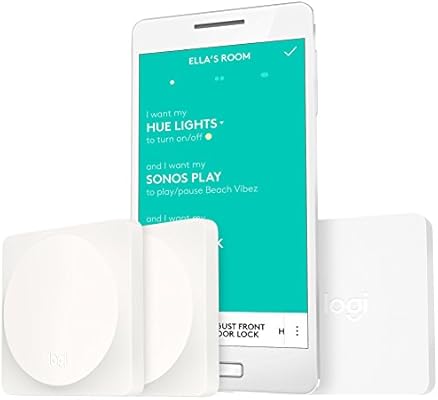

(US and U.K.) Logitech has just released a new button, which basically acts as a one button remote. It’s quite large, about the size of a drinks coaster, and will retail for about $40. It comes with its own Bluetooth bridge which is a little wallwart that plugs into any outlet
![](https://global.discourse-cdn.com/smartthings/original/3X/3/0/3090e11db890beb45a77312953a6d38747bf58d2.jpeg)
At $39 each, this is an expensive option, but it will be very useful for some people. You do need to buy the $99 starter kit ( The bridge and two buttons) to get the Bluetooth bridge for your first purchase.
