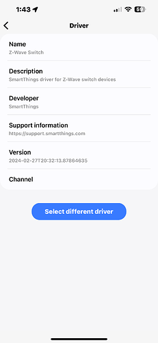

What Edge driver are being installed and used by the GE Switches. You may want to consider installing @philh30 Edge drivers for GE/Jasco and switching your devices to them (if you are not currently using them).
I haven’t had to ever use another driver so I’ll look into how to do that. Thanks for the help
I got the drivers installed no issue but when I select change driver in the app it says none. Others do show the new drivers.
I don’t believe you will be able to switch in the Advanced Web App either for the Edge driver but you can try.
You may want to try removing and reinstalling the device(s) to check if it driver is picked up or allows you to switch the driver if it isn’t picked up when you pair. If either does not solve the problem… check if the fingerprint of the device matches what is available in the custom Edge drivers. You can find the finderprints in AWA or API Browser +. Not sure if those GE/Jasco Edge drivers are still being actively supported by the developer.
You can find the fingerprints supported by the driver using the API Browser+ that @jkp mentioned. Go to Hubs->Your Hub->Installed Drivers->Details->Fingerprints. Compare the fingerprint of your device with those in the driver details to see if it is supported.
