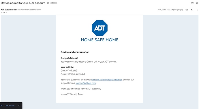

Hi, I have been using the ADT hub and been paying for monitoring for about 3 months now. Everything has been working great until 2 days ago when my ADT billing cycle came and I was charged for my monitoring service. I received my receipt email from ADT, but I also received the following email from them:
Device add confirmation
Congratulations!
You’ve successfully added a Control Unit to your ADT account.
Your activity:
Date: 07-05-2019
Details: ControlUnit added

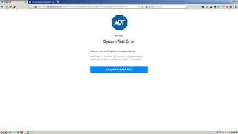

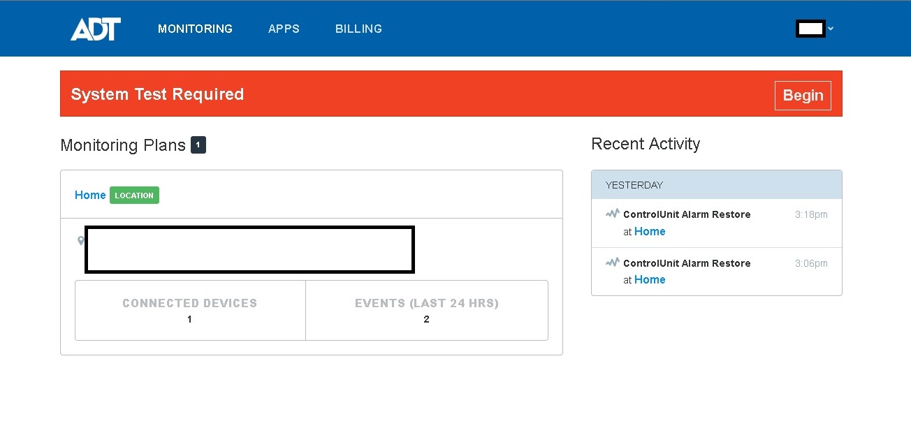

I have not added or changed anything to my device. Ever since that email, my app has the “System Test Required” label. I have tried to do the required system test, however it instantly gives my the System Test Error message and tells me to call ADT.

This is the message I receive when I try to do the test:

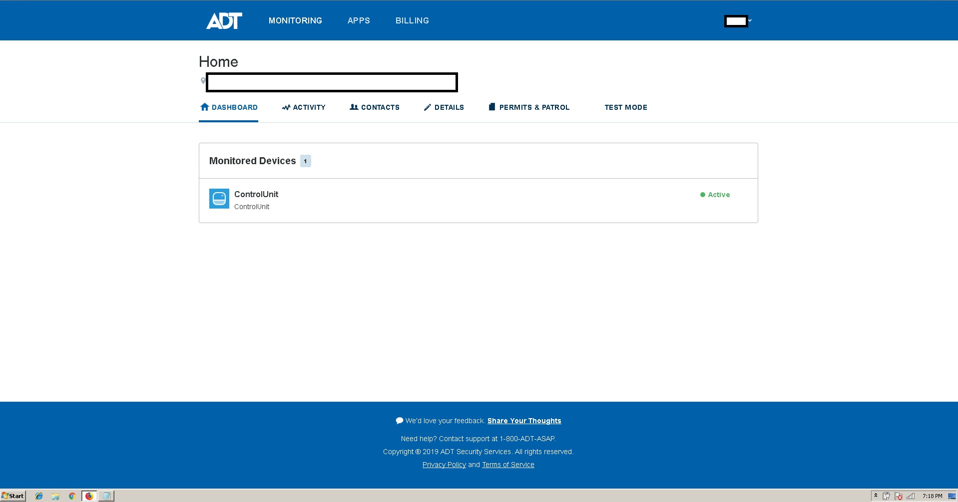

Also when i log into ADT canopy, all my sensors seem to be gone from the list

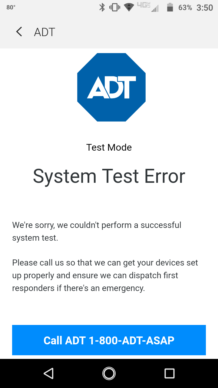

The error seems to be related to the sim card. As soon as it checks for 4g signal it seems to fail and the url is redirected to “/sim-error”

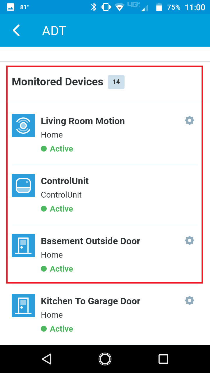

I have the same duplicate sensor issue. Signed up for ADT monitoring today. Unable to complete the System Test because my sensors appear multiple times.
See screenshots. I have triggered all of my sensors, but duplicate sensors appear and cannot be triggered.

I manually removed the duplicate sensors using the following procedure:
  1. Login to adtcanopyportal.com
  2. Click on your location name from the dashboard page. (There is a green location badge next to the clickable name.)
  3. You will be presented with your monitored devices. You can delete duplicate devices by selecting the gear icon next to the device and selecting “Remove Device”.
My duplicate sensors have the same name. I was able to determine which sensors are bogus by comparing the list of sensors on this page with the list of sensors from the System Test (see previous post screenshots). They are listed in exactly the same order.
I deleted the sensors at the position in the list which did not respond to the System Test.
Note: I am unable to delete the duplicate ControlUnit.
