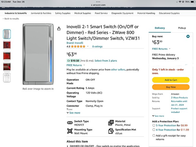

Well i thought i purchased my switches on amazon but i couldnt find them in my orders so ot must have been bestbuy or lowes & i called jasco but am not getting anyone. So looks like im buying new switches. Was looking to get inovelli switches but eveeything is backbordered so probably ge switches again. @JDRoberts i know zooz makes switches also but amy other zwave or zigbee switches compatible with smartthings. I checked eve but says it only compatible with apple. Kind of disappointed about inovelli switches being back ordered because his switches are better then the jasco ones.

Inovelli is certainly another good brand, just, as you noted, they seem to often be out of stock. :thinking:
@JDRoberts i have spmw zooz products but inovelli swithes seem so elegant… not sure what word’s to use & i always thought inovelli switches were the most advanced. If jasco replaces my switches then im good for now, well until next project but if they dont ill give zooz another look. Your lots more knowledgeable then me but i always thought inoveli switches were the Mercedes of smart switches.
Inovelli and Zooz both started out as budget lines, but both evolved over time.
Zooz kept the mid range pricing but continued the startup mindset of offering the latest and greatest engineering features from the independent zwave standard. Design looks like a mass market product, well built, but looking pretty much the same as most of the other big Z wave brands. They do have some really nice multifunction devices with multiple buttons. They also opened up an Amazon storefront to increase availability.
Inovelli evolved in a somewhat different direction, with increasingly more expensive pricing and really slick design, what I would consider a gamer aesthetic. While also keeping up with the newest generation Z wave features. And adding an interesting line of Zigbee products as well. But with continual supply chain challenges. You can often find inovelli products sold on Amazon, but only by third-parties; they don’t have a brand storefront there.
So, from an engineering standpoint, I think the two brands are very similar for zwave, and both have historically had good customer service. Zooz is priced at about half the cost of an inovelli zwave switch with similar features. Inovelli Models do tend to look more expensive because of the unique design. Whether that’s worth the extra cost is a personal decision. Choice is good. :sunglasses:
Inovelli does offer a line of Zigbee switches, and is working on a new line of matter over thread switches, so, if you’re looking beyond Z wave, they would continue to be a candidate.
