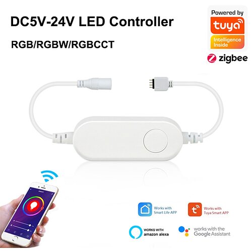

I’m thinking of trying Tuya. They have a few Zigbee versions:
I’m not sure how well they work in Smartthings, but it is not a high price to pay, not sure of the cost to Italy.

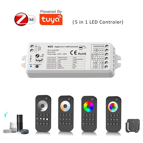

Or maybe this one is a winner?
or this one?
so many…
