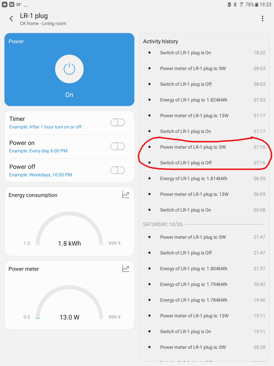

Here’s a couple of screen shots. No, not using the Timer, Power on, or Power off options on the plug.
The schedule named “LR on - Every day 07:16” seems to be the culprit, but I can not find it in the new Android app (not the classic). Even though initially named as an ‘ON’ schedule, I must of changed it to an OFF action

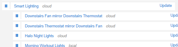

Then look for Smart Lighting:
Does the name of your activating app show up there (or anywhere in that list of smartapps)?

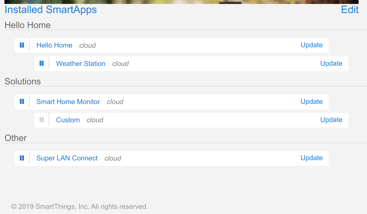

Thank you for your reply. Screen shot shows what is installed.
I was hoping that Smartthings would be easy to schedule a few plugs. Have not installed any Smart apps or device handlers. Have not integrated with Alexa, IFTTT, or any other product. Created several automation schedules to test, thinking they would easily be deleted, but they linger on, making the system less usable when I’m away.

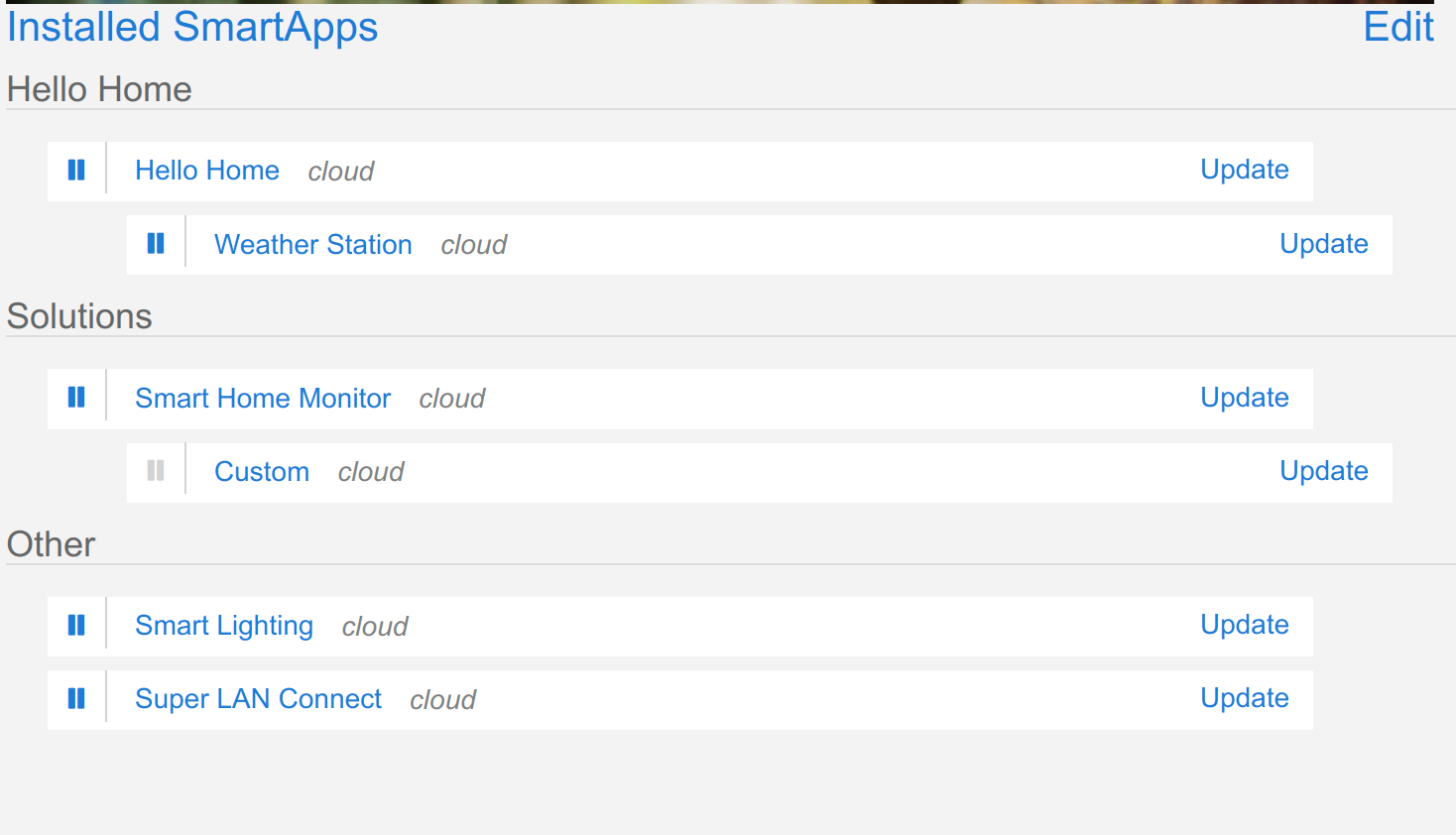

OK… had to use the classic android app to install Smart Lighting. But going back to the Smartthings website I see nothing under that app.

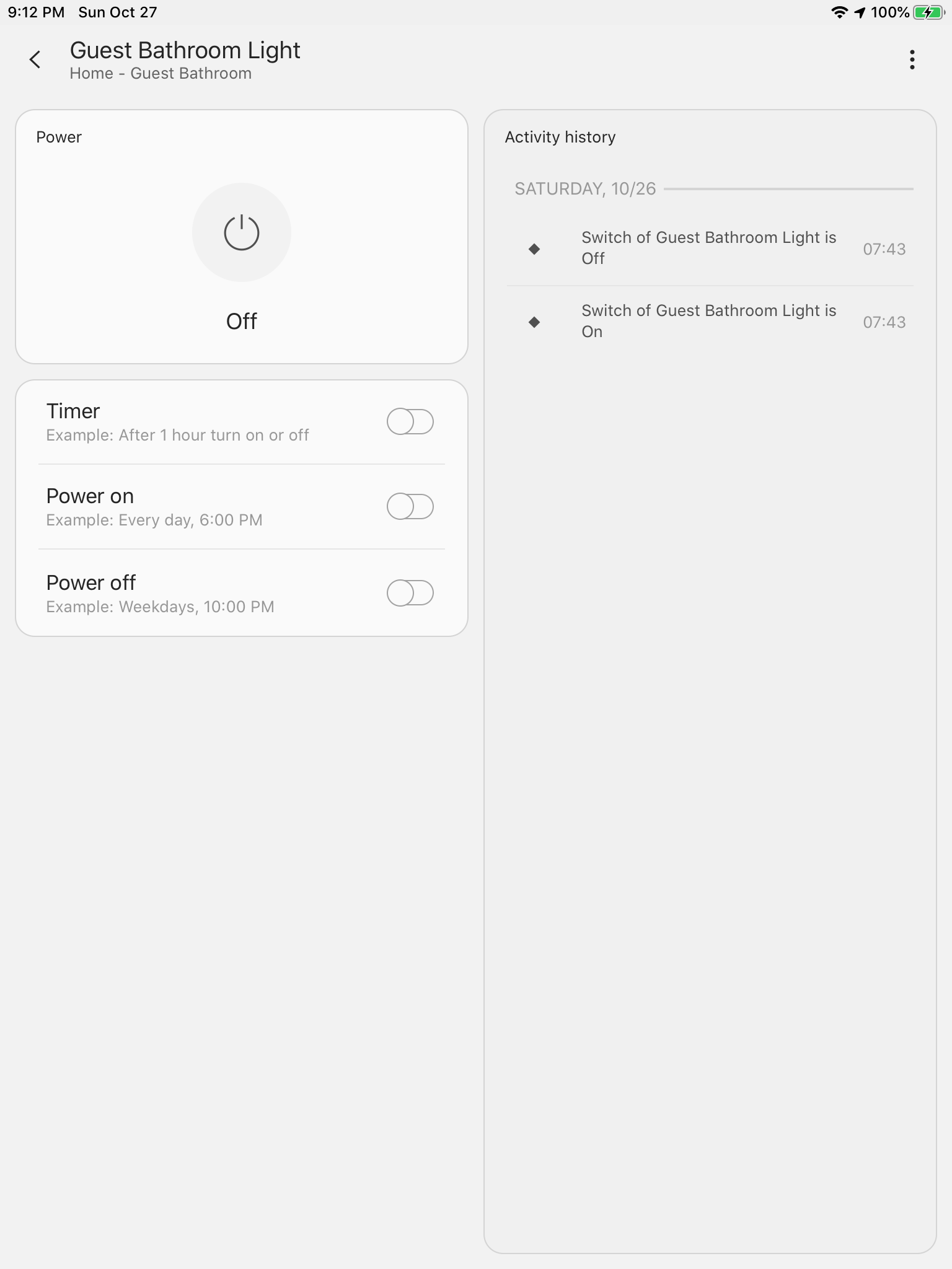

Below is a screen shot of the other plug (same make/model) that turns off at 2223 every evening. Really seems like both are exhibiting the same issue, and up to now been focusing on the one that turns off at 0716, assuming that once the culprit for the one is found the other one should be easy! I captured this one yesterday evening, and can get the other one in the morning.

Here’s the log trace from the plug that turns of at 0716.

Nah, it’s usually not this difficult to be honest. Your situation is not the norm, but I also have experienced this.
You can see the “off” at 7:16:01AM, but there’s nothing else to point back to with regards to saying why, who, what is causing it. Definitely an odd duck.
