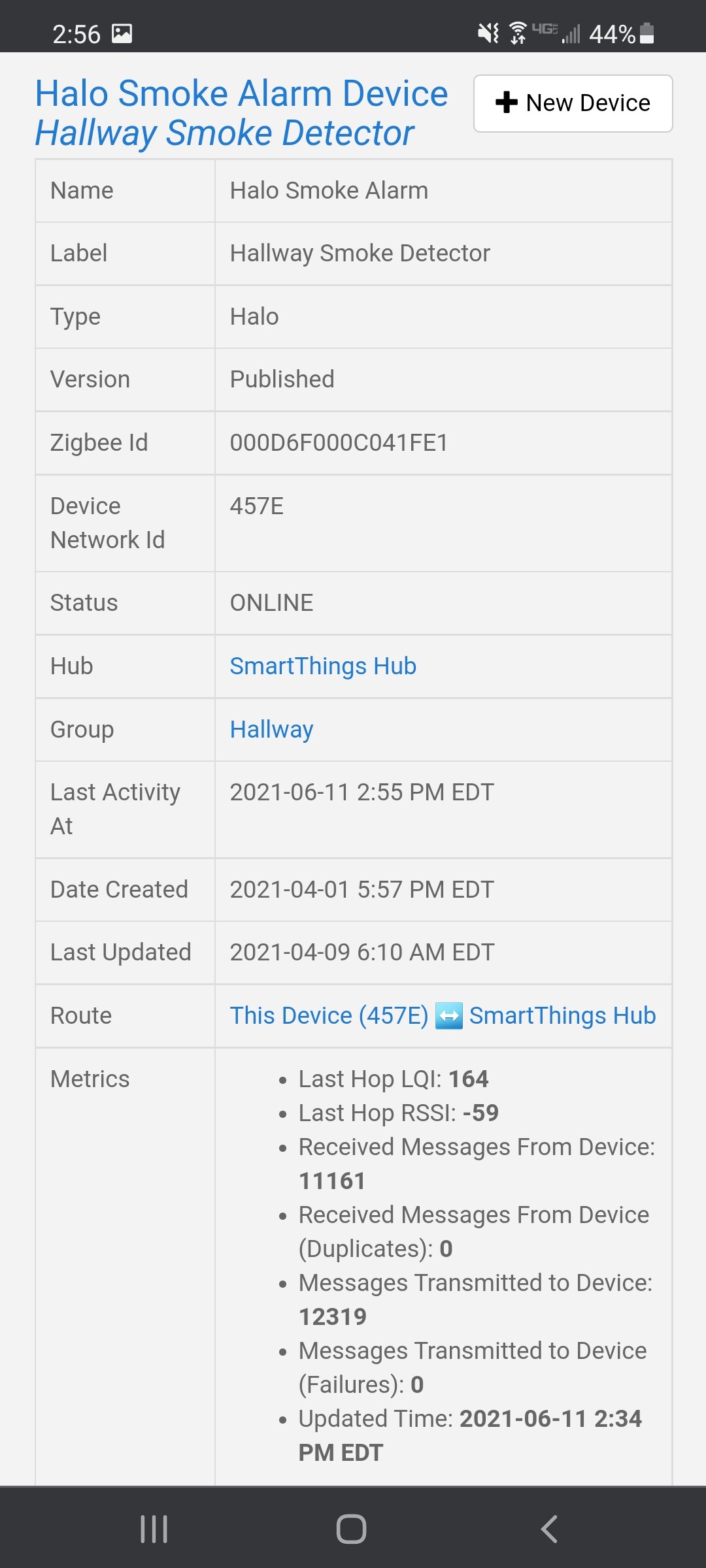

That’s not true at all. They still work just fine when joined to smartthings.

I see in the forum that some people say they still have theirs working and some say they have had difficulty adding new ones. But I’m glad if it’s working for you.
They still join as a zigbee device to your st network and if you have a plus model, you still get weather alerts.
Yup, what @saosinx88 said. I joined one not too long ago, but you have to use the Scan nearby option.

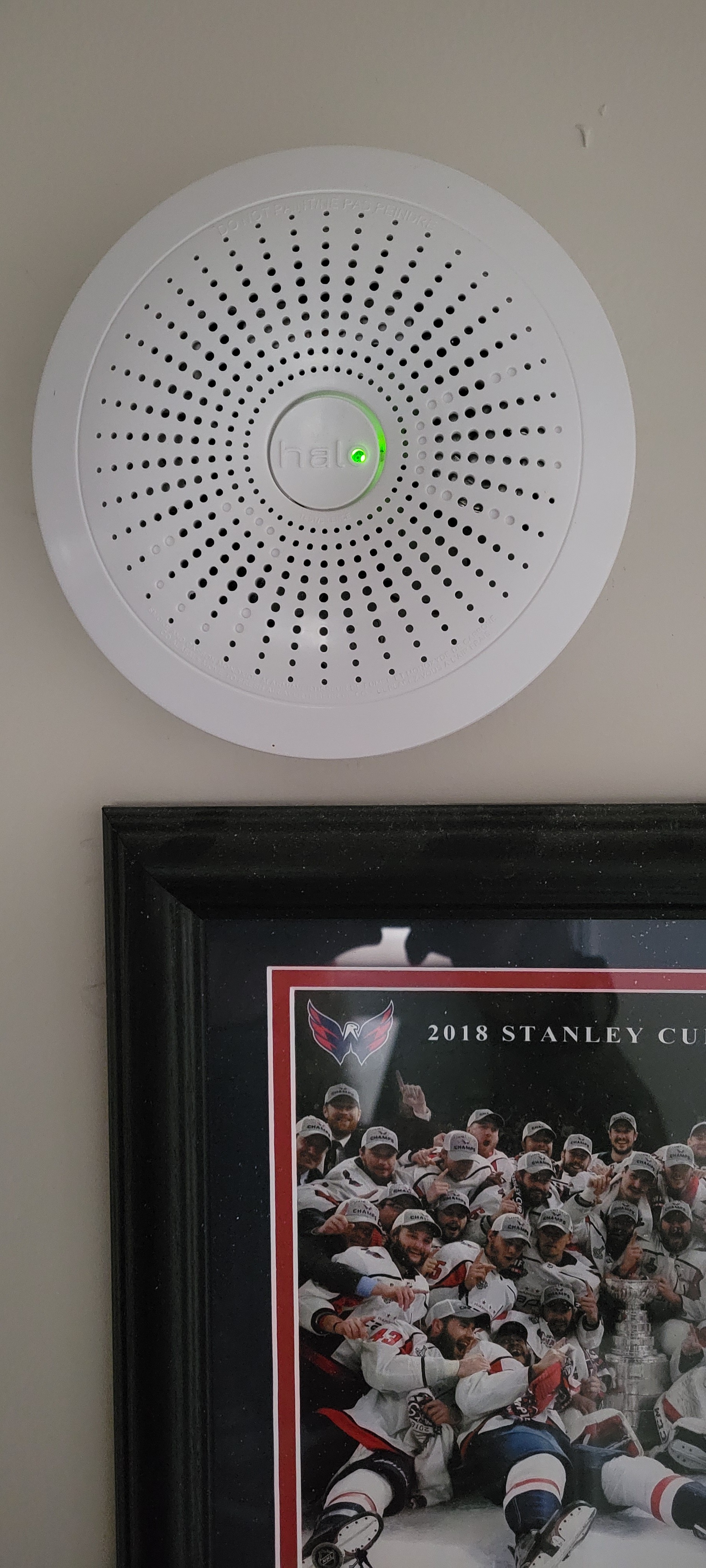

It’s too bad these guys folded because this device is nice. I have them everywhere and they make great night lights too with that LED ring.

I love my HALO. Seems to work great. Haven’t been on fire yet, but I will update this post if I die in a fire or from CO2 poisoning. :wink:
