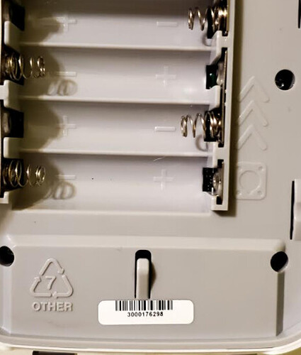

Oh my gosh mine will not do! Just hung up w samsung. Can you help? Sth eth 200 sn: 3000176298
Can you send a picture of the bottom of the hub to support@smartthings.com? I’m not sure why it won’t reset but it is claimed already, likely by the original owner.

Thanks @Rebeccadel. Give it a try now. It looks like the previous owner had a SmartApp failing to uninstall which is why the reset wasn’t working.
Finally! It worked!
