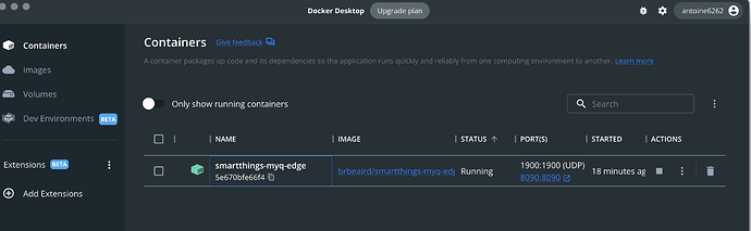

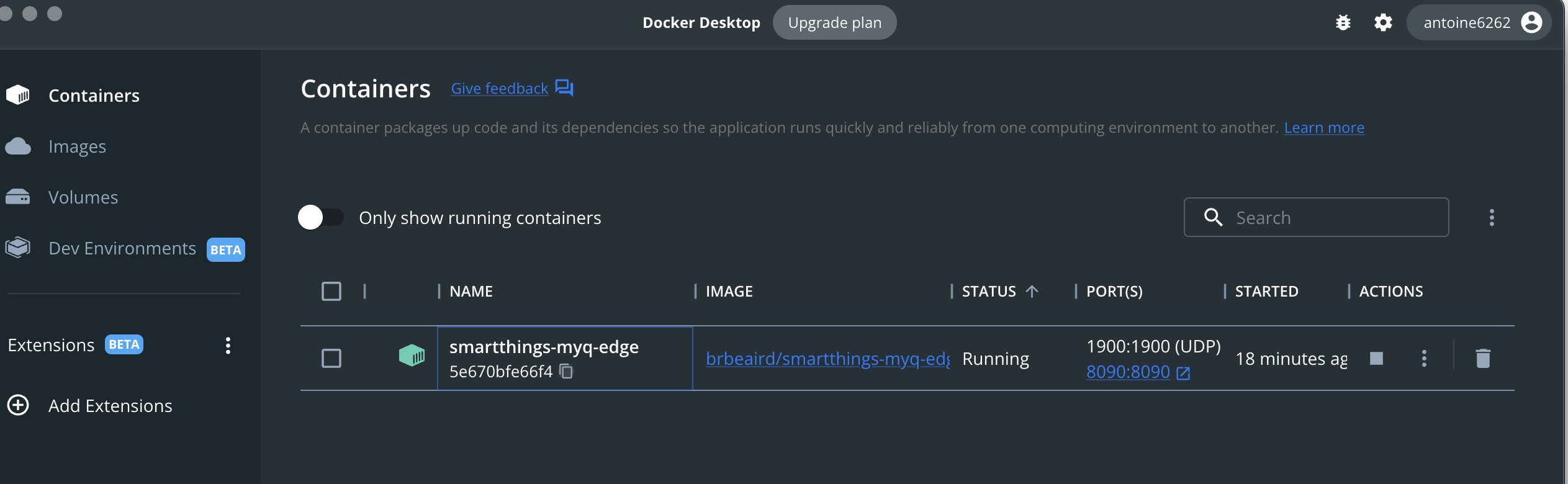

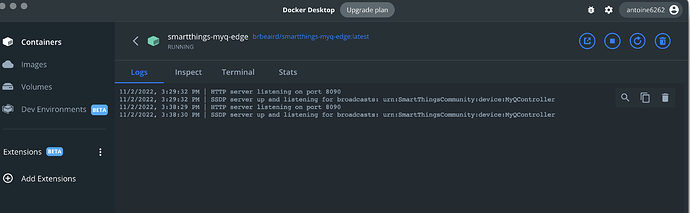

So, i was able to run the executable for the docker in the directions and then the container shows the following in Docker Desktop…
Still getting the “awaiting credentials” in the app
Open the MyQ-Controller device in the SmartThings mobile app, tap settings, then put in your username/password. If you had something in there previously, change the interval or some other setting to trigger it to re-send.

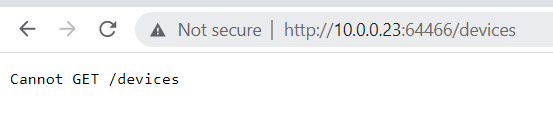

Devices link is failing.
192.168.4.200:8090/devices
Cannot GET /devices
@j18hockey, maybe you’re seeing the same problem I am. If you hit the server URL/devices, do you get a response? I get a “Cannot GET /devices” response.

I get that same response when trying to path to http://[IP]:[Port]/devices
I get the same response

Right - that is a POST endpoint now, not get. However, I just put in a status endpoint to help with troubleshooting. Can you update your server code, start it back up, and then hit this in your browser: http://serverip:port/status ?
