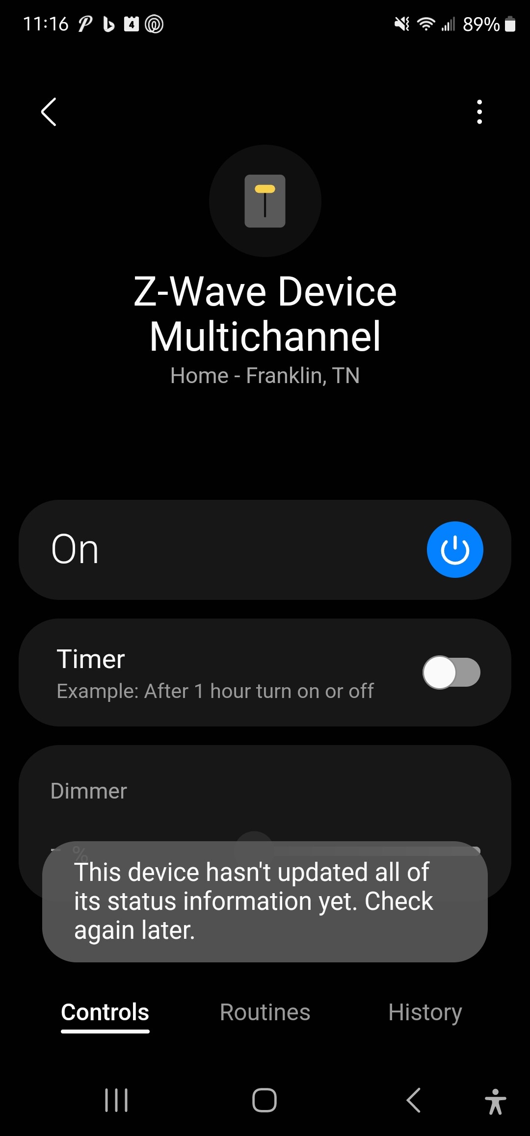

Got my ZEN17 MultiRelay and included it into ST. Is this how it’s supposed to look? I’m a little confused as to how to configure each individual relay (to open/close the specific garage door.) I presumed there would be a virtual button for each relay, when looking at this device in ST.
