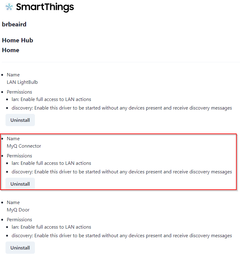

I had to install the MyQ Connector driver. The previous driver was called MyQ Door.
Thanks again for your tireless and well-documented work.

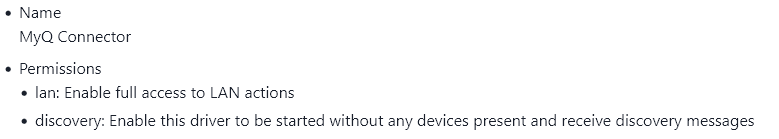

I assume you mean this one, MyQ: Connector?
As everything is working for me right now, I might wait a day or two for the dust to settle here.
Thanks for clarifying - I was not totally sure about that, but it makes sense.

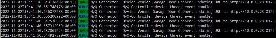

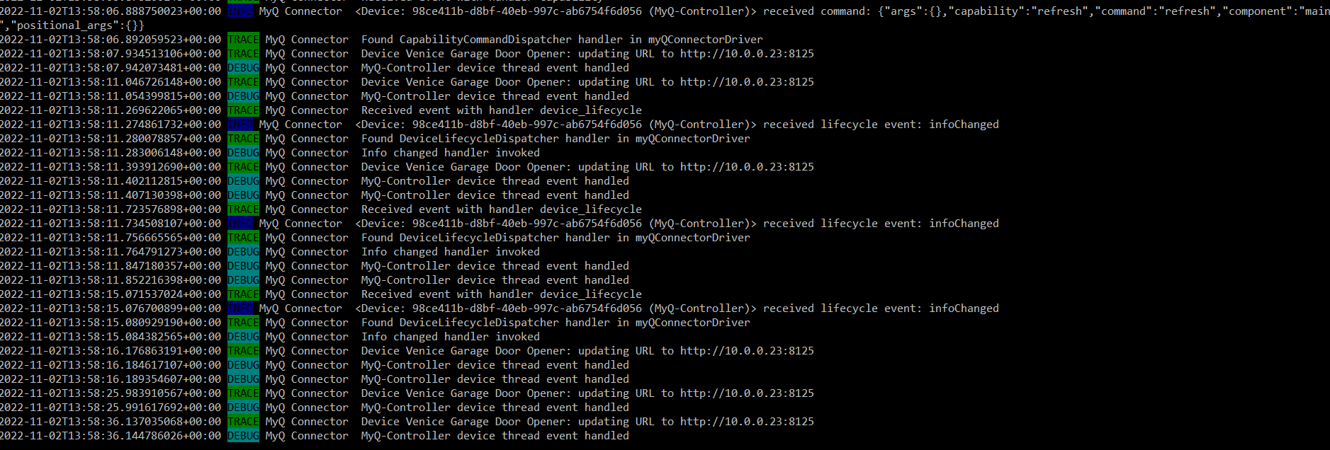

I installed the new server and driver. It appears the connection is working, but I am not able to get my garage door device to be created (I see the MyQConnector and it says it is connected). In the SmartThings logs I only see reference to the GarageDoor that is shared with me, not my Garage Door.
I’ve tried deleting and re-adding the connector, but I keep getting into the same loop. Here is a snip of the SmartThings CLI that shows the update that keeps repeating.
Is there anything else I can try or is there a better way to “reset” the MyQConnector?
Thank you!
If you update any of the settings on the controller (ip, port, user/password) it should reset the connection and try again. Did you manually enter that IP and port? What do the logs say on your myq server?

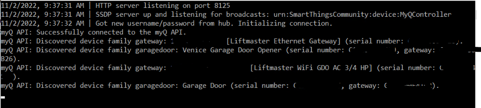

I have tried entering the IP and port. It looks like it refreshed, but I get back to the same spot.
Here is the output from the server.
Ok, I may have a bug in the manual IP/Port flow. Admittedly, I have tested that far less than just leaving those blank and auto-discovering. Let me check on that.
