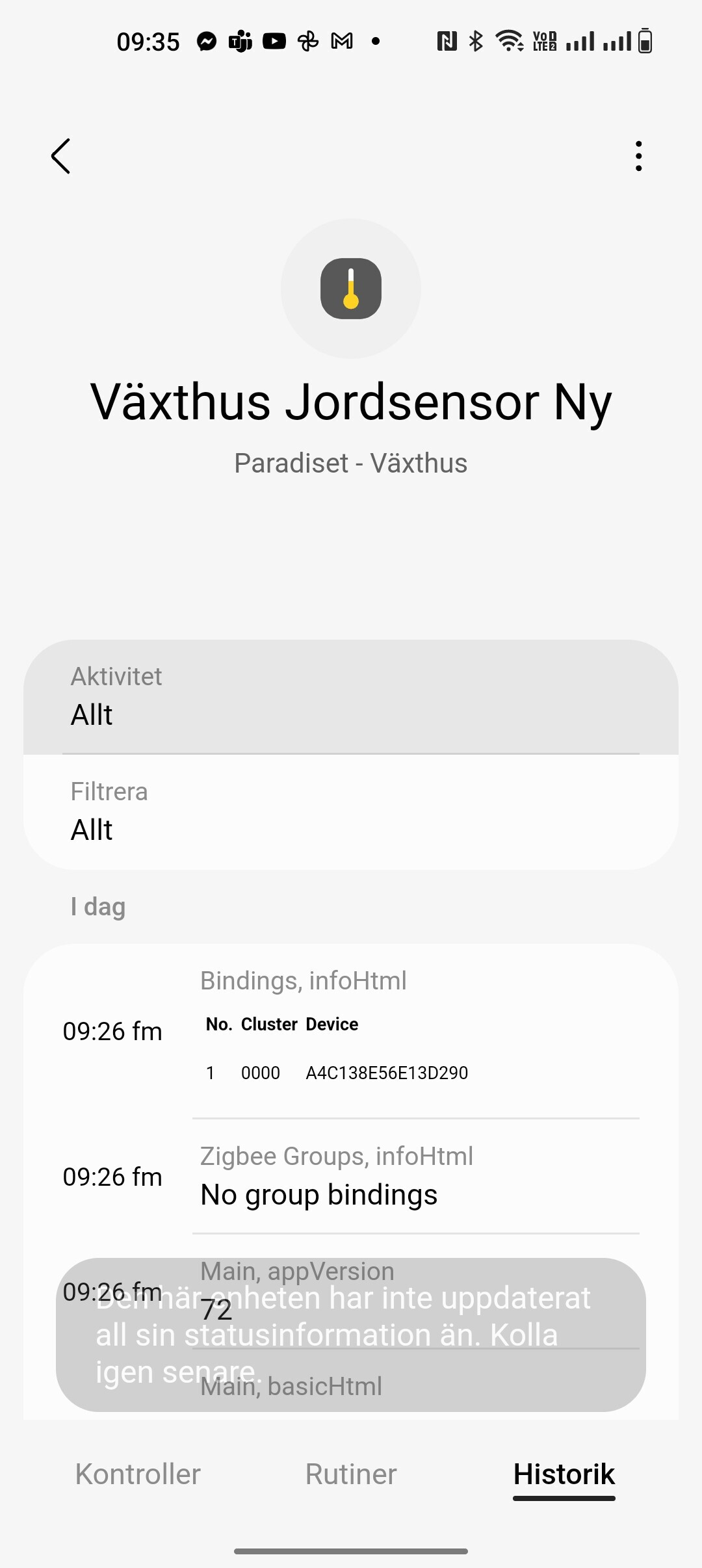

I think I am missing something.
I have installed the driver Public SmartThings Edge Driver - w35l3y (name: Personal Tuya Devices - main).
In the app, the humidity is presented. However, I don’t get temperature.
I also get error message (device could not be updated, try later).
Are you sure this is the right driver?
Mine doesn’t report this kind of messages listed in the history tab.
What did you do to reach that detail page ?
Have you changed profile manually in the settings ?

I have been testing several settings.
Now when I have removed the device and added it again, it looks like this:
