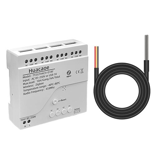

Looking for driver MHCOZY Zigbee Temperature & Humidity Controller
I found this device on Amazon and it is EXACTLY what I need for a number of applications, but mostly just to have a functional outdoor temp/humidity sensor that won’t have batteries that die the first time it snows.
Link Amazon.com: MHCOZY Zigbee Temperature & Humidity Controller, Extendable Probe Sensor, Tuya App Remote, 10A Relay Switch (T&H, 220, Volts) : Industrial & Scientific
The device has temperature and humidity sensors and a relay switch.
There is also a related version which only has the temperature probe (which I want to use for monitoring my pond temperature).
Link: MHCOZY Zigbee Temperature Sensor Controller with Waterproof Probe,Tuya app Remote 16A Smart Switch(tuya zigbee hub needed) - Amazon.com
Does anybody know if there is an existing driver for this device type before I buy it? I’m already using Mariano’s drivers, but I’m not sure if this would fall under the “switch” or “sensor” category and without a fingerprint I don’t know how I would even tell. I’ve tried a quick glance over the code on Mariano’s github and didn’t see anything that stood out to me as a “yes”. I also searched these forums and the internet in general with no success, so figured I should ask before buying one.
IF anyone would like to write a driver for this device, I’d be happy to pay for an extra so they have one to work with. I am mostly interested in the sensor features, since I already have functional relays and switches.

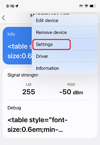

@Casabas for your reference (screenshots below)
  • Use Wesley’s “Personal Tuya” main driver
  • Use the “Generic” profile (should be the default since the fingerprint isn’t recognized)
  • Open the device in the app and go to Settings
  • Set temperature DP to “102”
  • Set humidity DP to 103
  • Leave the MHCOZY device and confirm child devices were created
  • Open the Temperature child device and go to Settings
  • Set Rate to “1000”
  • Wait at least 12 hours? I guess?
  • If you need switching capability, combine this with a separate switch device
I’m only testing with the USB-powered “Temperature and Humidity Controller” device. The other “Temperature only” device is only AC powered and my bend power cord is plugged into another device right now. I was able to switch the temperature probes back and forth and the USB device worked with both. The humidity seems to be accurate out of the box. The temperature sensor updates regularly, ~1x per minute, and is responsive once it starts reporting correctly.
If I switch the driver profile for the main device, the child devices stop receiving updates. The Temperature and Humidity profiles for the main device still don’t work, only the Generic profile with the manual datapoints. I still can’t get the switch to work.
Mariano’s drivers don’t work because they only support the standard Zigbee clusters. It can control the switch on standard cluster 0x0006 but cannot interpret the Tuya EF00 data. (I don’t know what a “cluster” is in this context, I presume it’s just a word the Zigbee protocol uses for a collection of data and control signals.)
I think Wesley’s driver doesn’t work because it only supports the Tuya EF00 cluster, and not the standard Zigbee clusters. It can interpret the Tuya EF00 cluster data, but doesn’t seem to know the 0x0006 cluster exists.
I’m going to get the second MHCOZY device plugged back in and see if it starts behaving, too.

Thanks so much for posting all the steps and the screenshots. Being new to this, it took me quite a while to suss all the basics but I finally figured everything out and your steps made perfect sense. About midnight, when most of my fellow country men were celebrating the New Year, I was celebrating the sight of a temperature reading on my ST app.
For anyone who’s trying to do the same. I made some notes summarising the process and links I followed:
By just searching for ‘personal tuya’ on the SmartThings forum site I was able to find a post by Wesley “[ST Edge] Personal Tuya Devices - Generic EF00 Device”
At the bottom of the page is a github link to info about Wesleys driver:
EdgeDrivers/personal-tuya-devices at main · w35l3y/EdgeDrivers · GitHub
Within the page is a link to accept the driver:
At the link Samsung account
Click ‘Enroll’
Click ‘Available Drivers’ This takes you to the drivers page
Install the ‘Personal Tuya Devices – main’
I think once the above is done the driver becomes available via the mobile app. Next add the MHCOZY device from scratch and the driver is applied to the device. The variables need to be set as per JCs walkthrough process. JC’s screenshots in the thread above made following the process a lot easier.

The OP’s device is the 1CH switch, I got the 4CH version (TYZGTH4CH-D1RF): Amazon.com: Zigbee 4CH Temperature Monitoring Switch,120V Dry Contact Smart Relay Module,Tuya App Remote Control,with Waterproof Sensor Probe(Tuya Zigbee hub needed) : Industrial & Scientific
Basically, I want Switch 1 to turn on device if Temperature (from device’s probe) equals to a temp (and same turn it off when temp is lower). Same for Switch 2, 3 and 4.
Because it’s a very similar device, I was wondering if you could create a driver off this one you already have for the 4CH + Temp Sensor version?
Many thanks!
