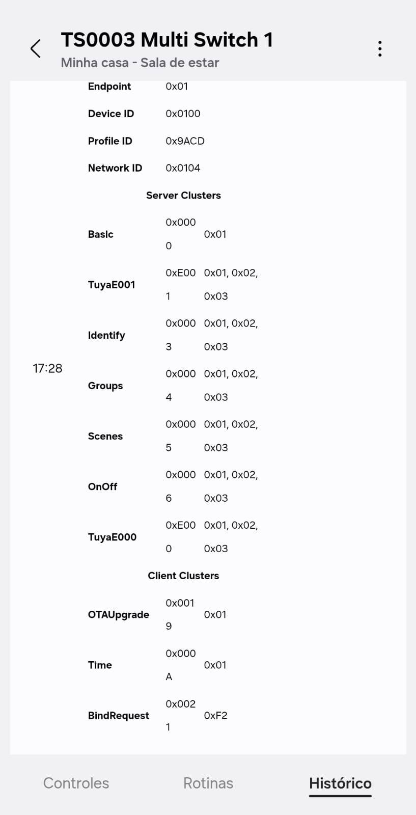

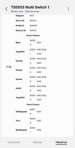

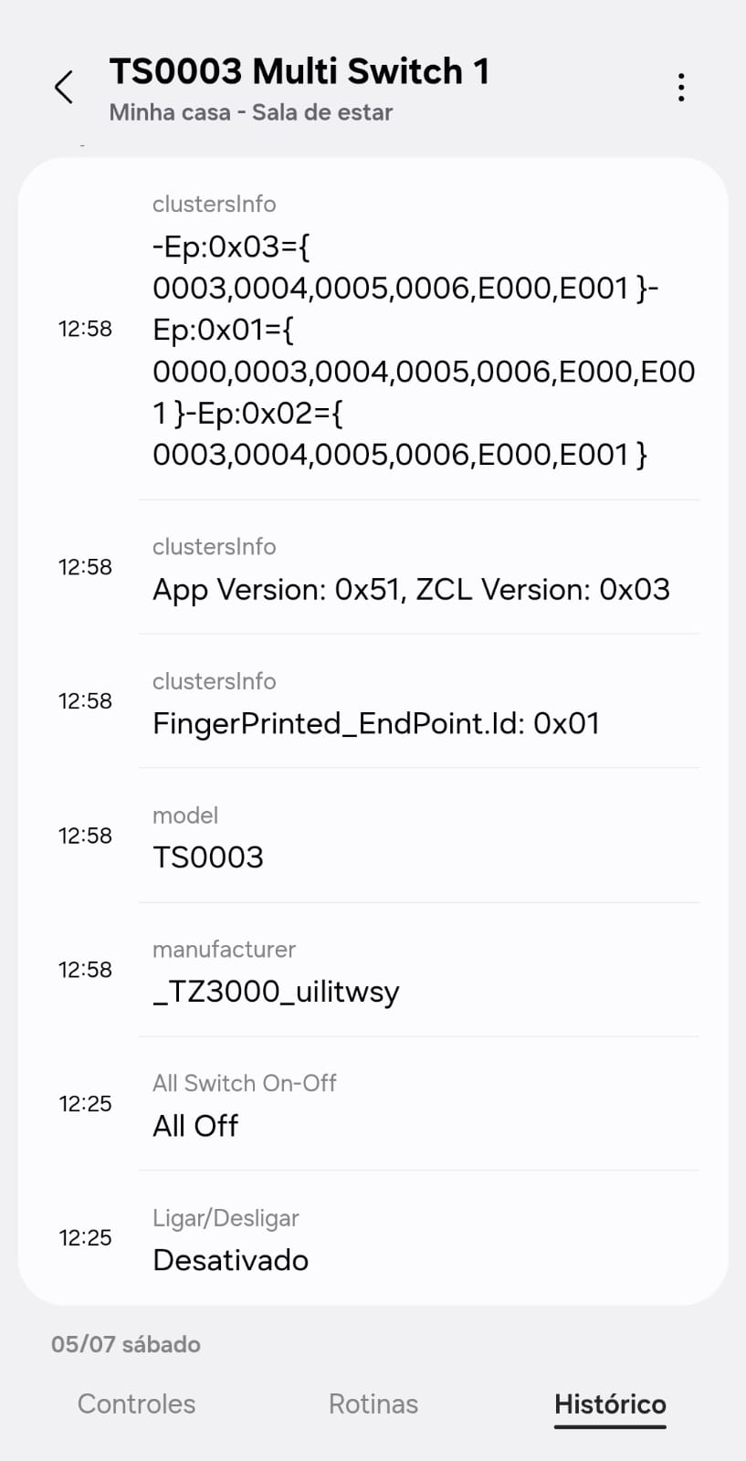

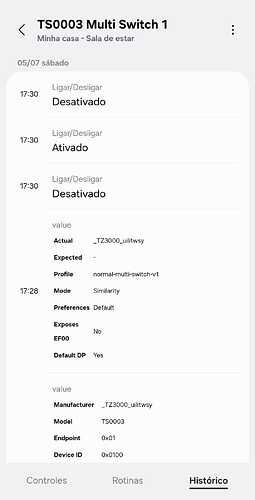

HI Mariano, I have a Zemismart model TS0003 6 GANG Switch (not 3 as I have seem here) by manufacturer _TZ3000_uilitwsy, and when I try to use your “Zigbee Multi Switch and Child Mc” it only recognizes 3 of the gangs.
Are you able to add this model and manufacturer to the Edge Driver, and recognize the 6 gangs?
DO you need any other information ?
Unfortunately Mariano is no longer active in this forum or updating drivers.
You can try using @w35l3y Default Clusters driver. Should work fine with 6 switches
Hi @dotan_shai , thanks for the help, when using the @w35l3y driver, it doesn´t create any child devices. Don´t know what to do, anyway I sent @w35l3y a message to see if he can help me.
