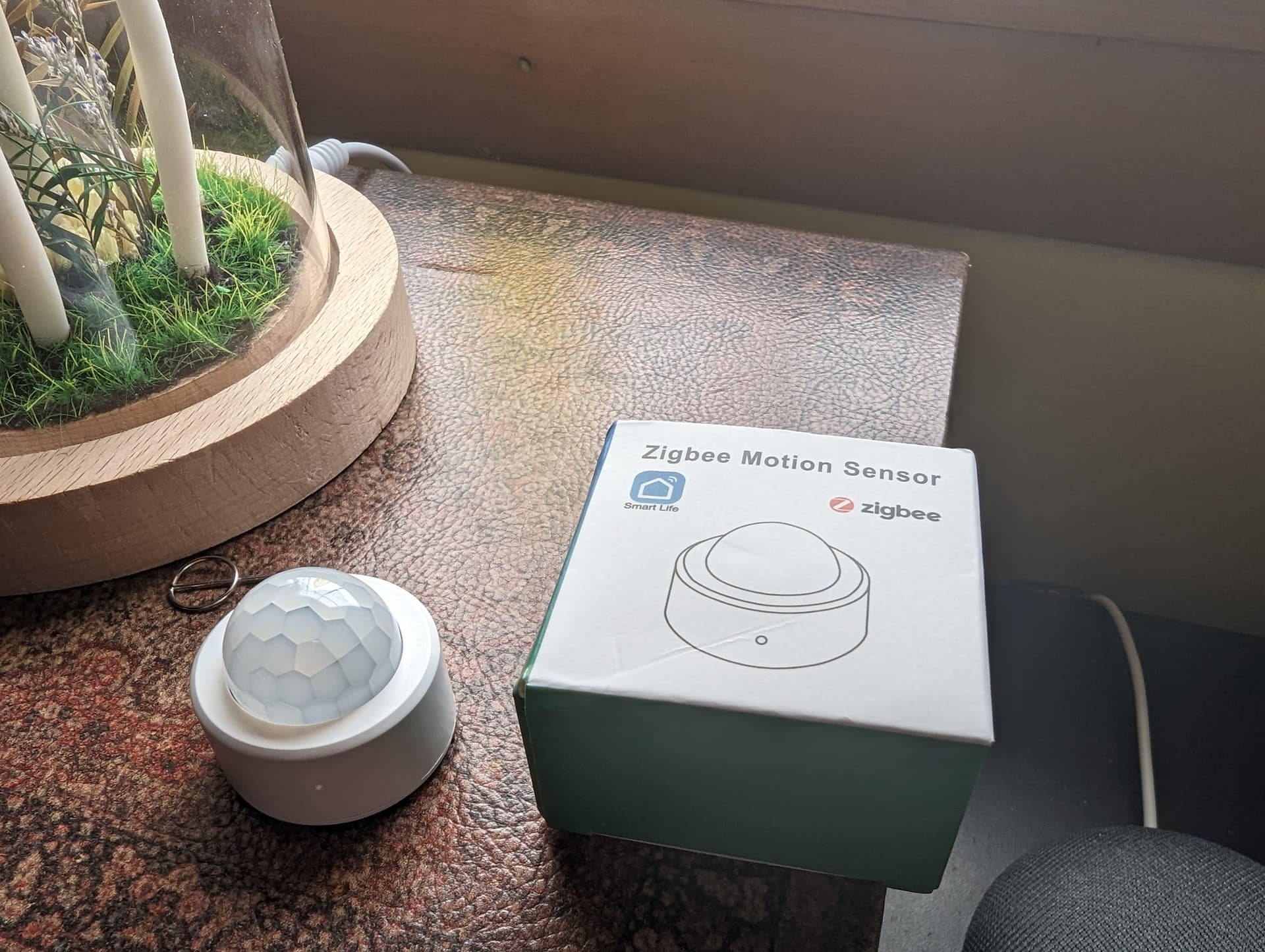

Can someone please help me to get my tuya TS0202 manufacturerTZ3040 motion sensor working.
I have installed the drivers but it gets detected as a generic thing when I try and pair it to the Aotec.
I have tried uninstalling these drivers and have tried using the edge driver-Mc ZigBee drivers from Mariano_Colmenarejo for ZigBee motion sensor.
I tried enabling al of them at once through the invite links but nothing is working to get this device recognized as a motion sensor ,it says generic but the only settings I see are for temp offsets and shows a temp sensor icon.
With these drivers I can see settings and get info but with the other drivers I got nothing and couldn’t click on the device in the the app, I could only long press add get edit but there were no options to do anything.
I have tried install just these drivers and then just the MC ZigBee driver and then both at once,
Nothing works, and when I had both installed I went to change driver but it only gives the option for this driver and there was no option to switch it to the MC ZigBee driver either.
Hi @anthony_rossetti
I have to add the fingerprints to the driver Zigbee Motion Sensor Mc
As soon as I can, I’ll do it and let you know
None driver I developed will work for this device.
