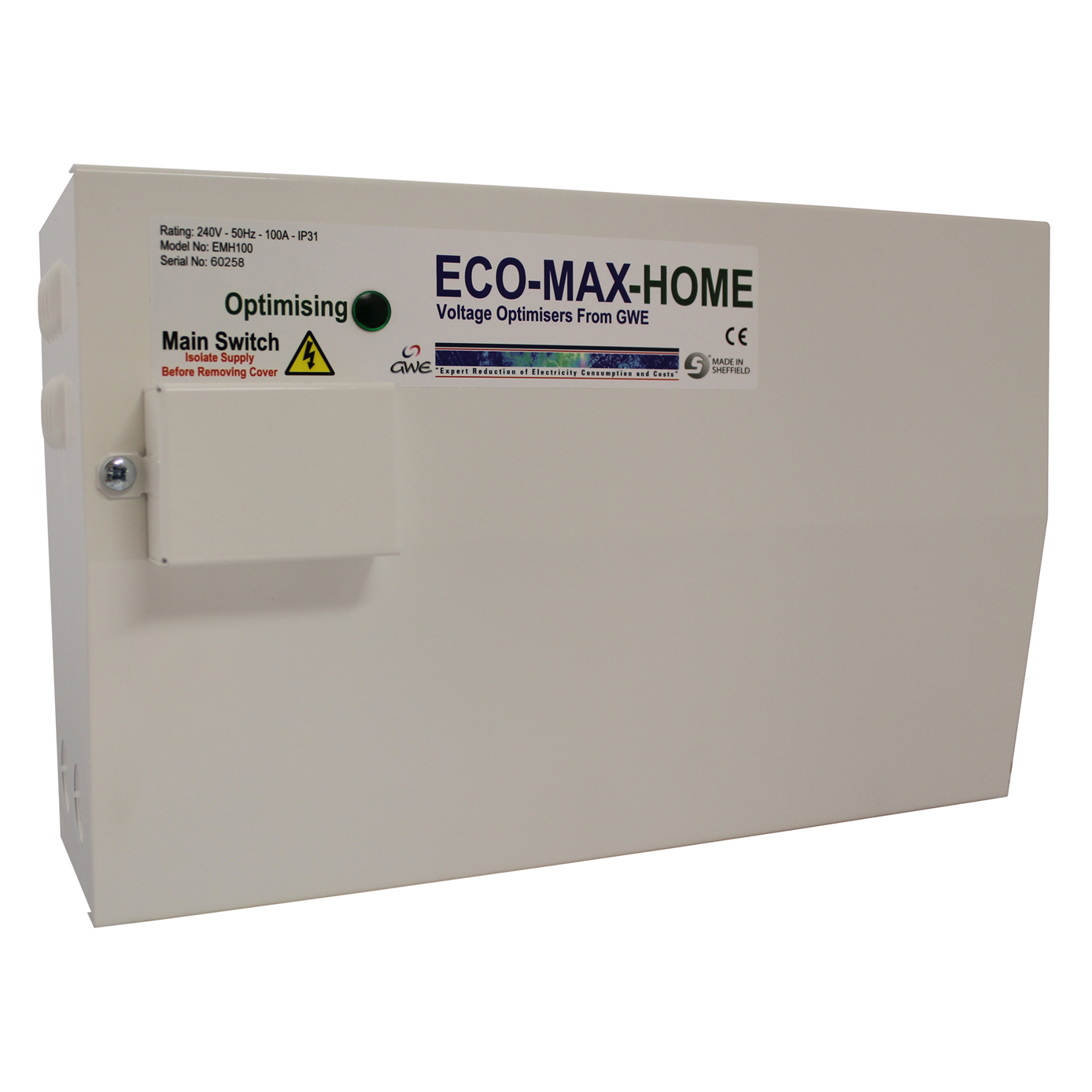

For reference, you can buy voltage regulators which will smooth out spikes, as well as limit the voltage. A big one capable of doing a whole home won’t be cheap though. A quick google threw this up:
Not necessarily recommending this, as it’s a big cost for potentially little/no payoff.
They’re quite rare in the UK though because our grid is extremely reliable. It’s not like in some countries around the world where power fluctuates wildly. Normally, people buy smaller ones to power specific appliances (servers, high end audio gear, etc) because most household stuff is capable of dealing with +/- 10% deviation from the stated range.
