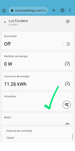

Hello, @nayelyz @andresg
I also confirm that if you do a refresh the device from my.smartthings.com refresh button it works perfectly.
It seems that it is the App, I use Android

UPDATE:
And from my.samrtthings.com, continues working fine
