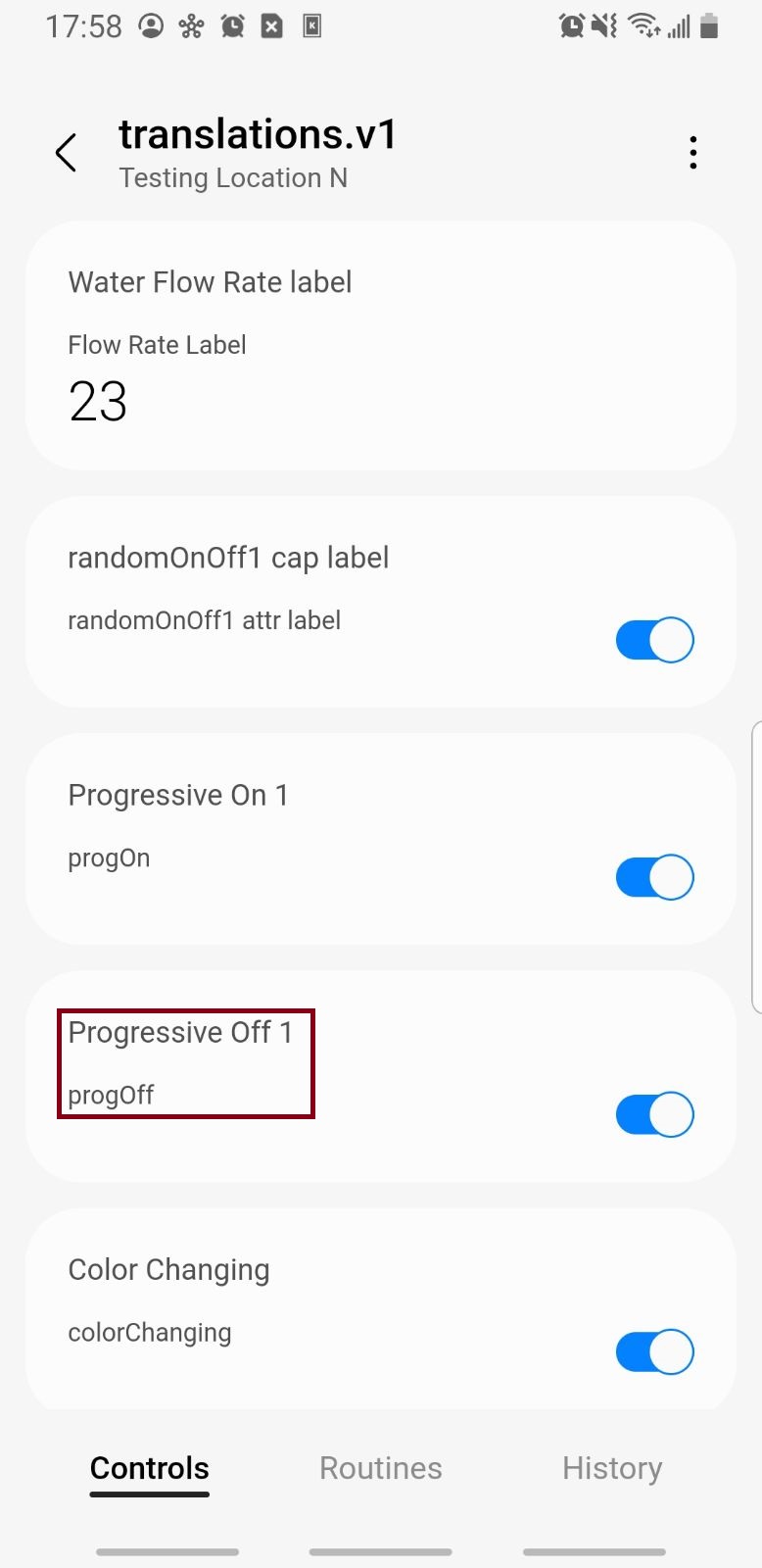

To update your capability labels:
Note: I discovered that if we create another capability with the same config, the “untitled” no longer appears, so, if it’s easier for you, you can do this instead. The Capability and Attribute name would still be displayed
Before the translation:

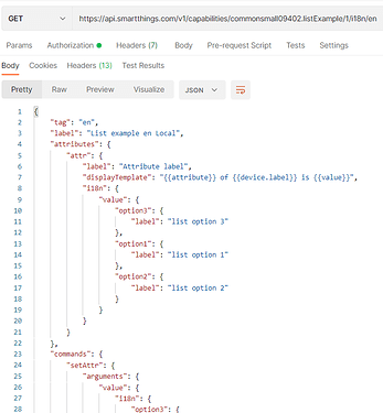

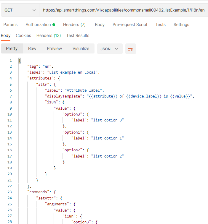

- Query the configuration from
commonsmall09402.listExample:
This is best from Postman because the CLI doesn’t retrieve the config injory(which I already reported)
URL:https://api.smartthings.com/v1/capabilities/commonsmall09402.listExample/1/i18n/en
- Copy the result in a file, this is what we’ll edit for other capabilities so you must be visualizing the capability presentation elsewhere to use the correct values.
- Taking the capability
commonsmall09402.progressiveOn1into consideration:
//the values in "label" are the ones that will be shown in the app:
"tag": "en",
"label": "progressiveOn1 cap label",
"attributes": {
"progOn": {
"label": "progOn attr label",
"i18n": {
"value": {
"Active": {
"label": "progOn is active"
"Inactive": {
"label": "progOn is inactive"
"commands": {
"setProgOn": {
"arguments": {
"value": {
"i18n": {
"Active": {
"Inactive": {
You can use the command create, if you get an error saying the translation already exists use update instead:
smartthings capabilities:translations:create commonsmall09402.progressiveOn1 1 -i capabilityLocalization.json
smartthings capabilities:translations:update commonsmall09402.progressiveOn1 1 -i capabilityLocalization.json
Note: remember to verify if the configuration was saved correctly by querying the translation in postman

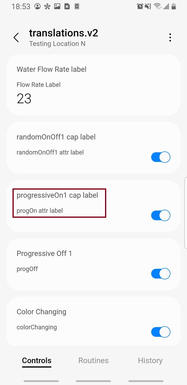

Verify if the device is using the latest presentation version - This is what the capability currently looks like:

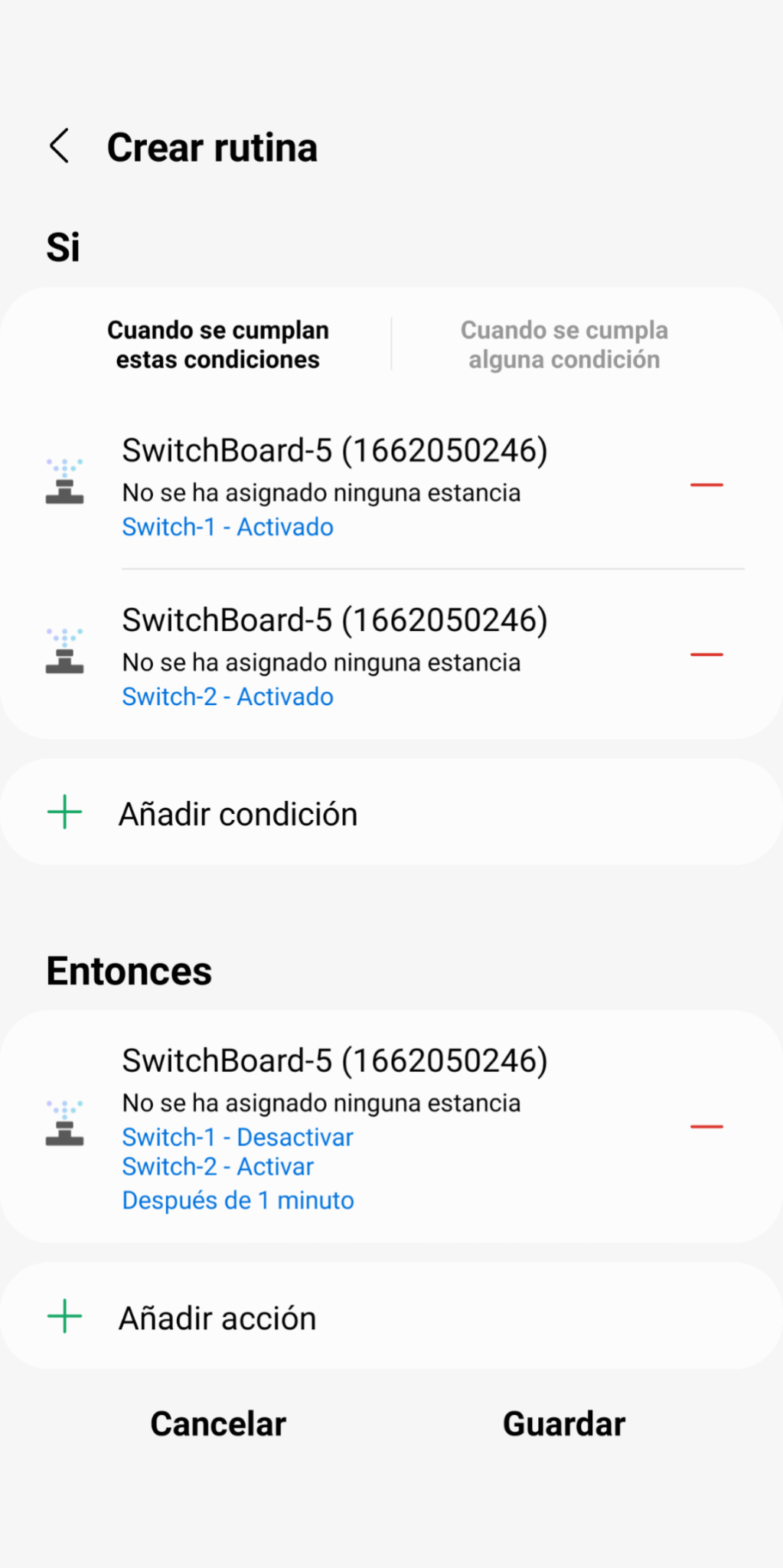

Hi @nayelyz

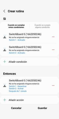

Automations actions for multi-component devices cannot be chosen independently in the same way as conditions.
I think it worked fine before, but I can’t be sure.
In Conditions Automations, you can choose each component separately and put a condition on each one
In Actions automations I have to choose all actions at once action for all components. If I need to delay any of them or turn it off after x time it affects to all components.
It shouldn’t work independent for each component, since in the presentation each component has its capabilities defined separately.
If i click in + Add action this device is not selectable
I already shared this with the team. I will let you know as soon as I have an update.

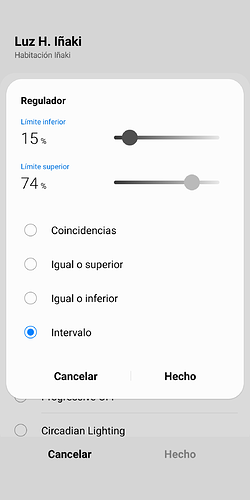

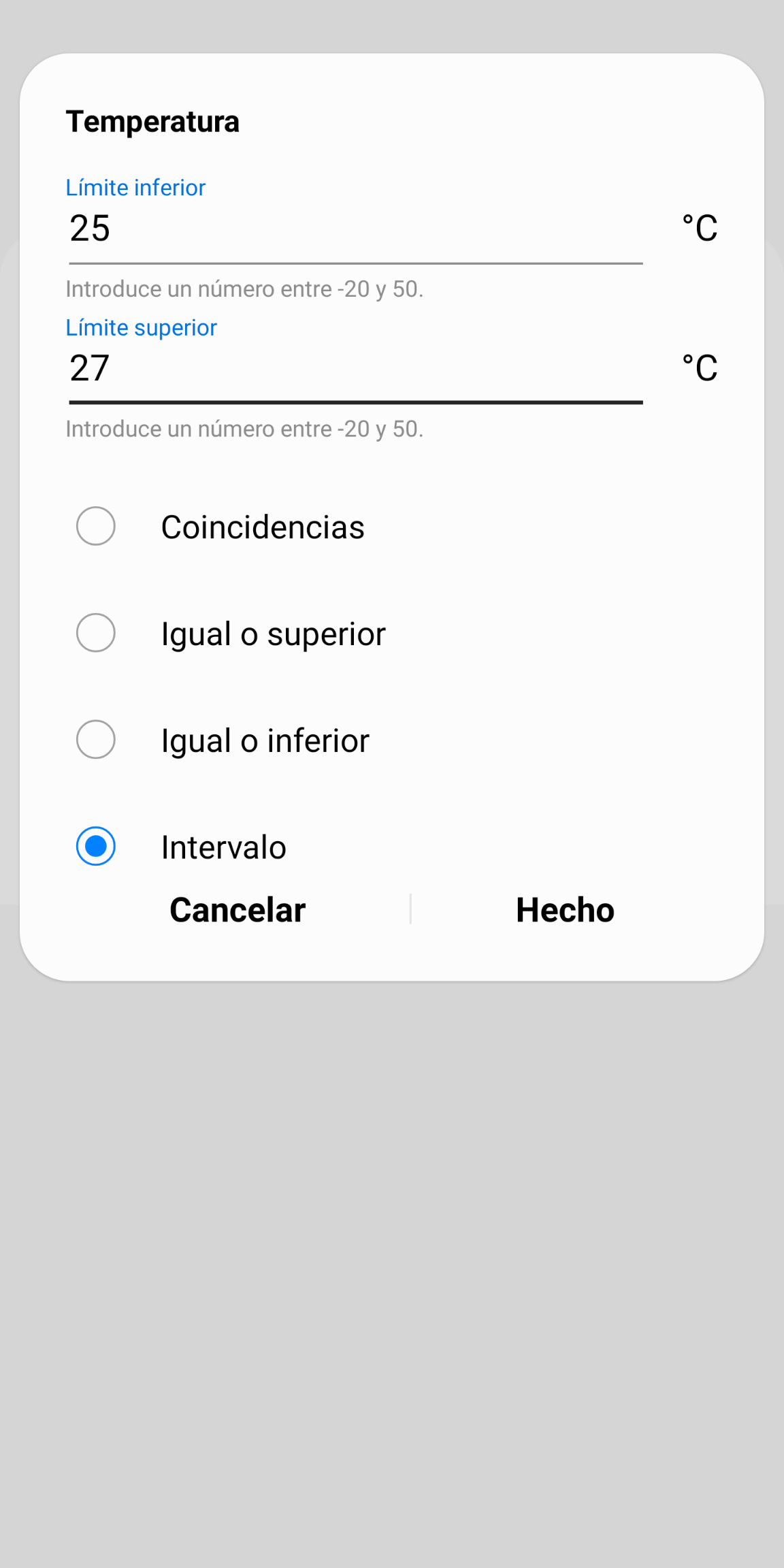

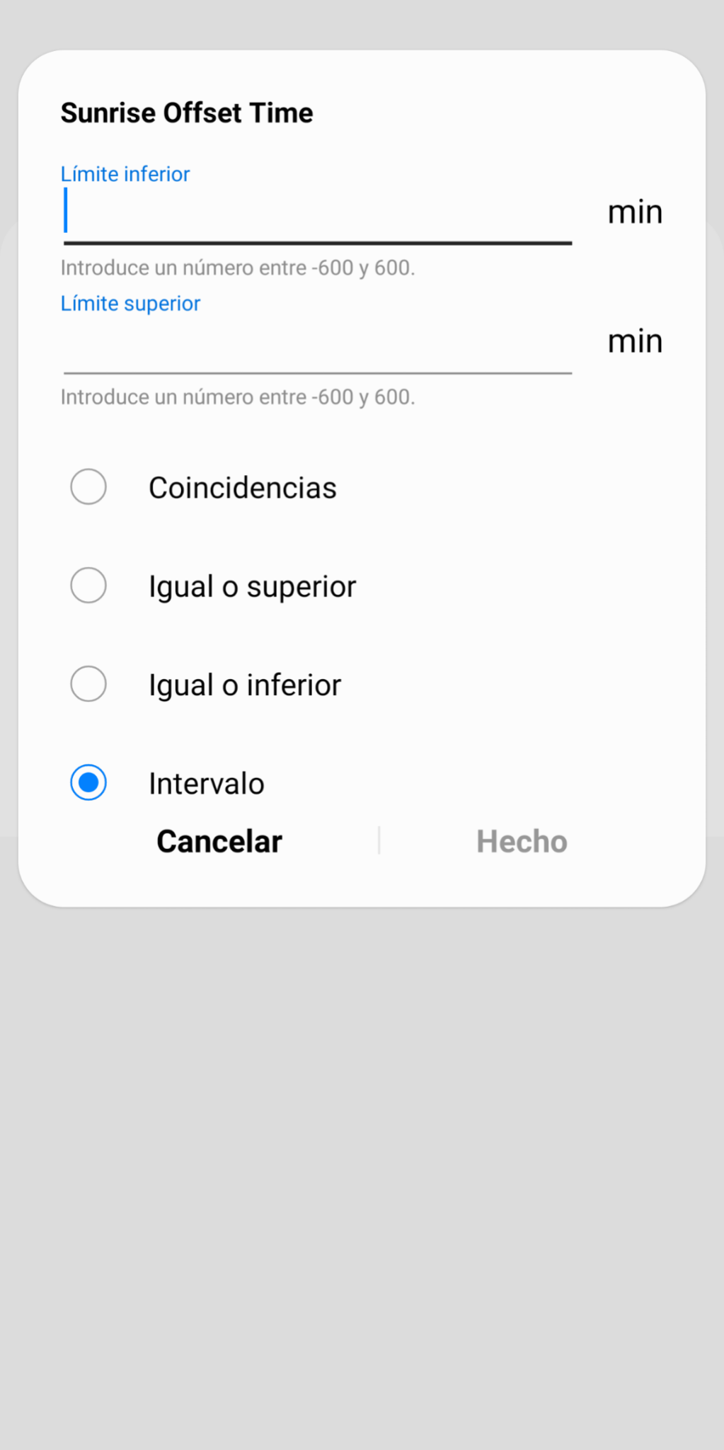

Hello

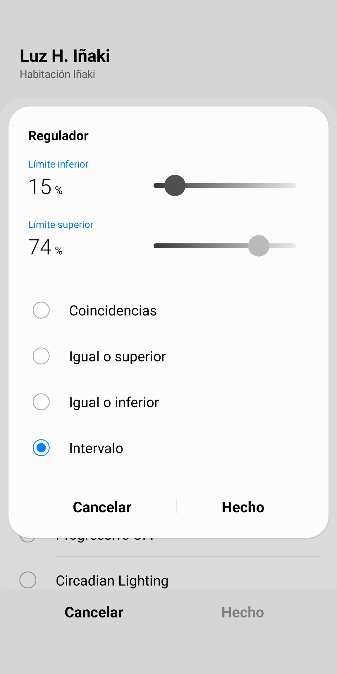

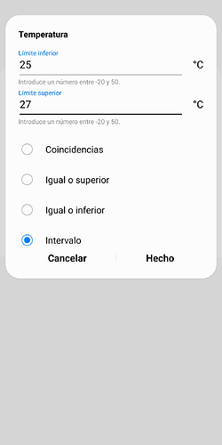

Something has changed in the automations when smartthings adding the intervals in the conditions and now the automation does not fire:
- When the condition coincides with the minimum limit in intervals
- The equal or greater condition when the value is coincident. If you put >= 9 and the value is 9 it doesn’t fire. you have to put >= 8
- The condition = does not fire
It seems that the equal comparison is not done correctly in some cases, although the condition <= works fine
I tried with virtual calendar, temperature and others capabilities numeric type
It’s driving a lot of people crazy and it took me more than an hour of testing to see what was happening

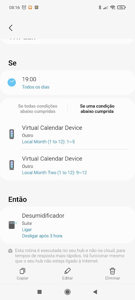

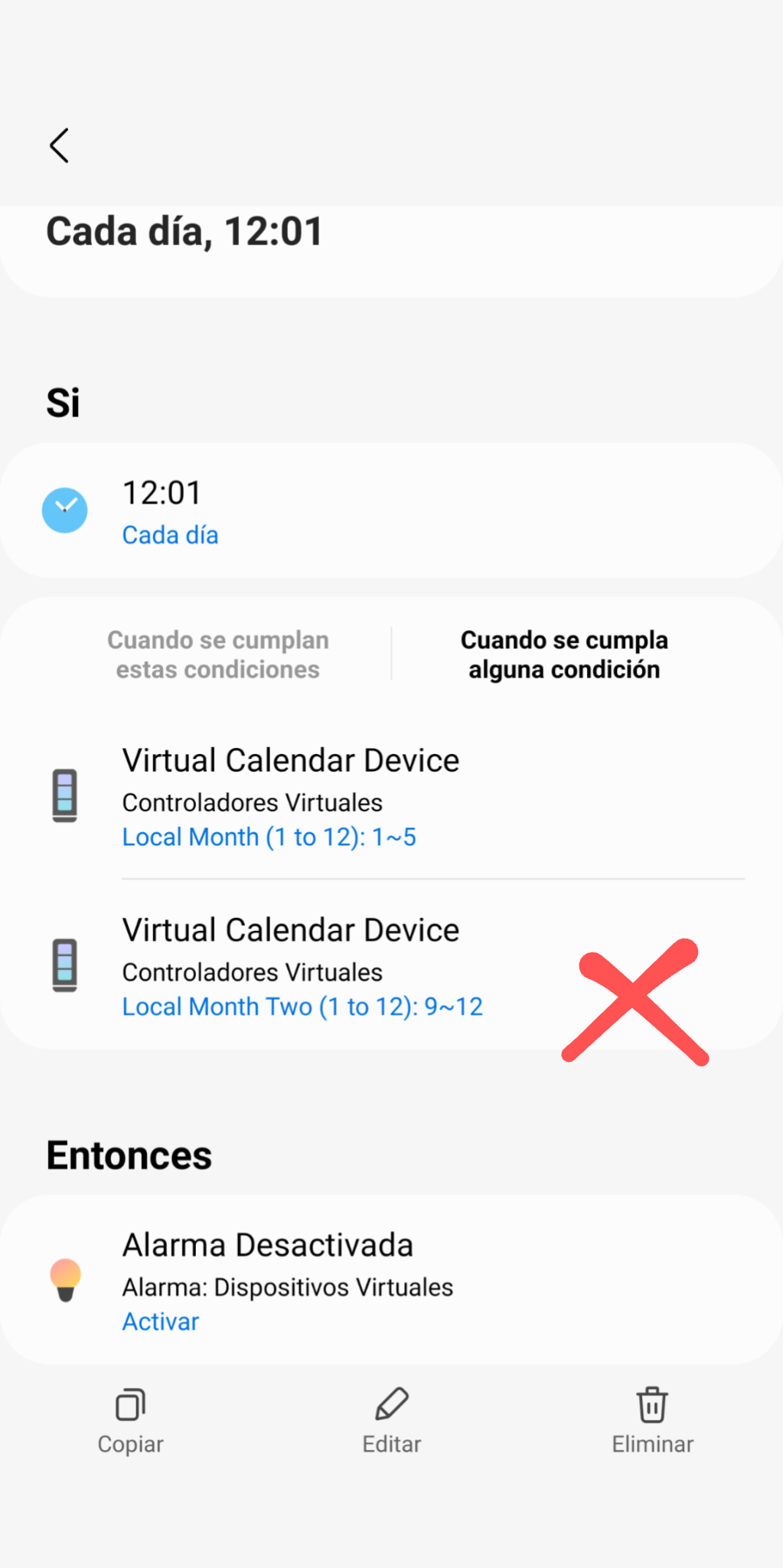

This user says now working fine, but to me not work yet

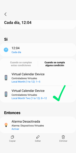

This condition works for september month (9) works fine

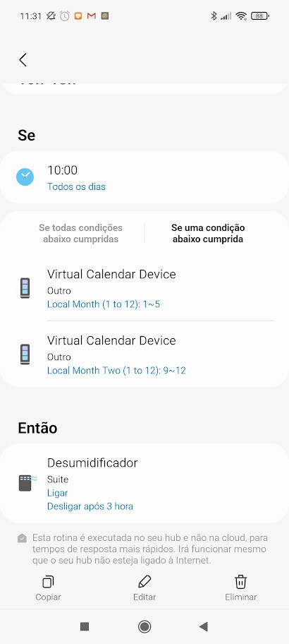

This condition works for september month (9) does not works

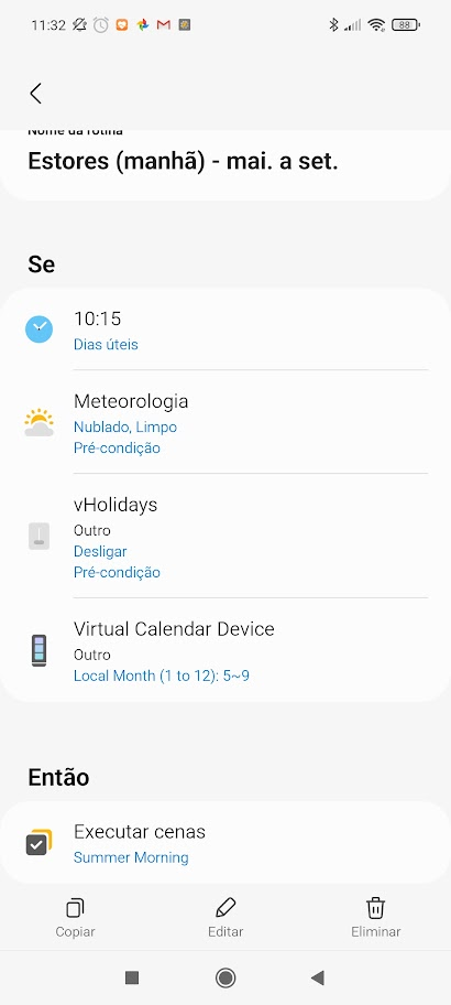

Yes, yesterday my 7pm routine for the dehumidifier did not work, but today, the 10am worked fine (they are equal, just the hour changes).
And I have another one to blinds that also worked today at 10:15, but int this case it’s not the minimum value, it’s the maximum.
I already reported this to the team. I will keep you updated.
