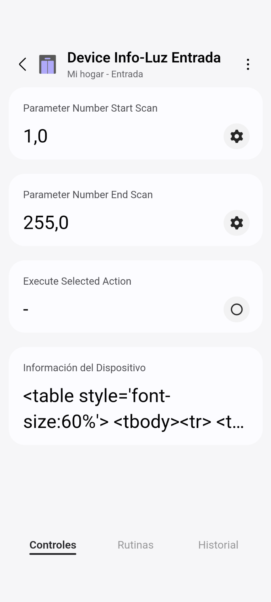

Also, the text type capabilities have stopped displaying text in HTML format, which was the only known way to display text in more than two lines and with different font sizes in the App capabilities.
It doesn’t make much sense that text-type capablities can be created with no character limit and then they can’t be displayed in the details view of the App.
Is there a way to make the capability size expand to show the full text of the event and give it some formatting?
Will they reactivate the HTML text in the App capabilities?

The team has removed this for security reasons, inserting HTML in this way was not planned and it doesn’t have support, the content limit is 2 lines, regardless of the length of the string. I agree with you that this could be confusing.
As far as I know, it isn’t possible. I have encountered a similar case before, but I am currently exploring other options (I do not promise that I will find it sorry).

I find it regrettable that they remove a procedure to display useful information for the user without offering an alternative and as always without prior notice.
If the html text format expands the size of the capability, how can it not be possible to expand it to show another text format? It doesn’t make any sense.
Sorry, I think it does make sense, they do not have the slightest consideration for their users and for the people who spend hours and hours making the smartthings platform a little more useful and attractive.

OK, but if HTML is not intended to be supported that should be decreed by the API. Otherwise the mobile app developers are making up the rules. The tail is wagging the dog.
That’s two lines in the mobile apps. Nothing prevents third party client apps being able to handle more lines.
