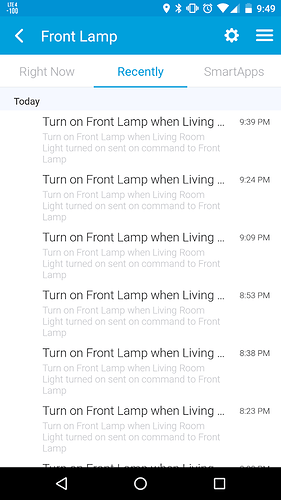

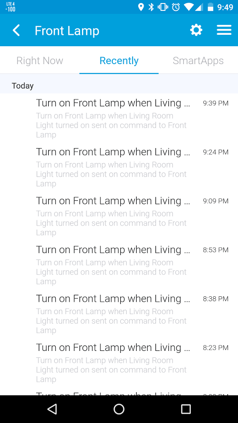

I have a Smart Lighting automation when I switch on my wall switch i want my lamp module in the same room to come on. When I watch movies though, I will turn off the lamp module manually from the app. Until recently this was working fine. However about a month ago the lamp module would randomly come back on after 2-10 mins. I check the recent history of the lamp module and it shows that the automation triggered it to turn the lamp on, but the wall switch never changed states. Is this a recent bug?

Is because of this…

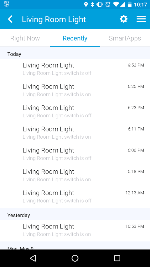

Also, what does the history for the living room light show? That seems to possible be where the command is coming from… Maybe you’re looking at the end product instead of the other end of the problem.
I completely deleted the automations. I may try excluding the switches and re-adding them as well. There was no activity on the switch that triggers the automation between 6:25pm and when i took the earlier screenshot at 9:49pm.
