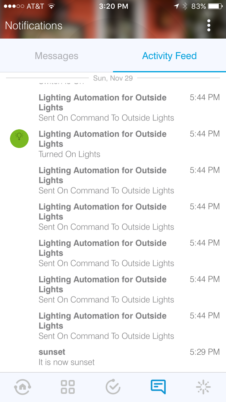

For the past 8 months the Smart Lighting Automations have essentially been broken because they repeatedly send the commands for the current state of the automation. This breaks all sorts of use cases for automations. More details:
I contacted support and the response a while back was that engineers were aware of the problem and working on a fix. Since this has now been a problem for 8 months I’m losing confidence in SmartThings ability to fix this and I’m getting so annoyed with the issue that I’m looking at switching to another system.
So one last ditch effort… SmartThings: Can you actually commit to a date when this will be fixed? Community: Are there any possible workaround, like http://smartrulesapp.com/ ?

The repeated commands in the activity feed is a different issue. I would still want my rule to evaluate repeatedly (on every condition met) but only log an activity if there is a change. It really does no harm, besides adding lines in the activity feed. I think the majority of users don’t look at activity logs that closely, I don’t recall the last time I did.

On the other hand, repeatedly sending the command of the single trigger can be deadly to your network. First of all, you’ve obviously multiplied the number of messages that your network has to handle, and this in itself Could cause other messages to be missed or delayed. Second, as the OP mentioned, it can really mess up “follow me” use cases where the first device going on or off is supposed to trigger something else.
A few months ago I had a single trigger issuing upwards of 30 repeated commands over several minutes. (I posted some of the screenshots at that time.). It did cause actual problems at my house. For one thing, the light couldn’t be turned off because it kept turning itself back on again. There were other issues as well. Support tried a couple of different things and eventually forced a local smart lighting automation to run in the cloud which seem to fix it at that time, but obviously lost the benefits of local processing.
