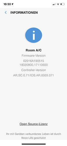

JPG Hi, I’m new to this forum, since I have installed a new aircond 2 weeks ago. I’m experiencing loss of wifi connectivity. First I thought it was because the wifi is switched off during the night, but yesterday a unit went offline during the day.
This is the version wich is installed:
To restore the connection I have to press and hold the “Timer” button on the remote controller and wait until the “AP” funciton timeout.
Any suggestion will be very appreciated.
Paolo
