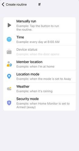

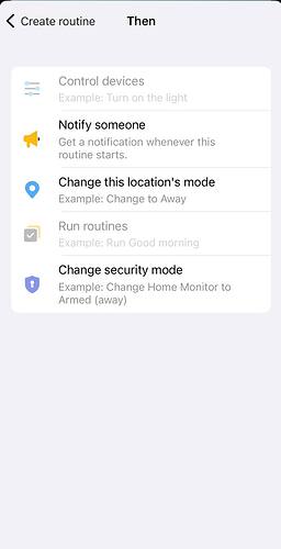

Hi. I’ve been trying to create routines in my smartthings mobile app. I’ve developed some devices using smartthings CLI. now I want to add some triggers for these devices. But when I to on if or then my Devices status can’t be clicked as an option and in ‘then’ the control devices can’t be clicked. How can I turn them on
@Kiarash_Kianian some virtual devices created from SmartThings CLI or my.smartthings.com have some limitations, What type of devices are you using? Could you share evidence about the problem? it sounds like there might be a presentation issue.
I have a Lamp virtual device. I haven’t yet made presentations but I don’t think the problem is coming from the device. You can see the limit in the pictures I provided.

@Kiarash_Kianian Sorry for the delay, I was checking the devices in your locations and I found 2 virtual devices both using a device profile that you created but unfortunately, both don’t have a presentation which is causing the issue, because the automation option requires a presentation.
To solve your case you can do the following
In the case that you can create a custom virtual device:
- Create a device config, in this case, you will need to create an automation view in other to add this option on the SmartThings App, after to create it you need to update your device profile. Documenation
If you need a “standard device”:
- You can create it using my.smartthings.com or use the smartthings cli to create one from the available list, this process will also generate the presentation. If you encounter any issues with these methods, please let me know.
