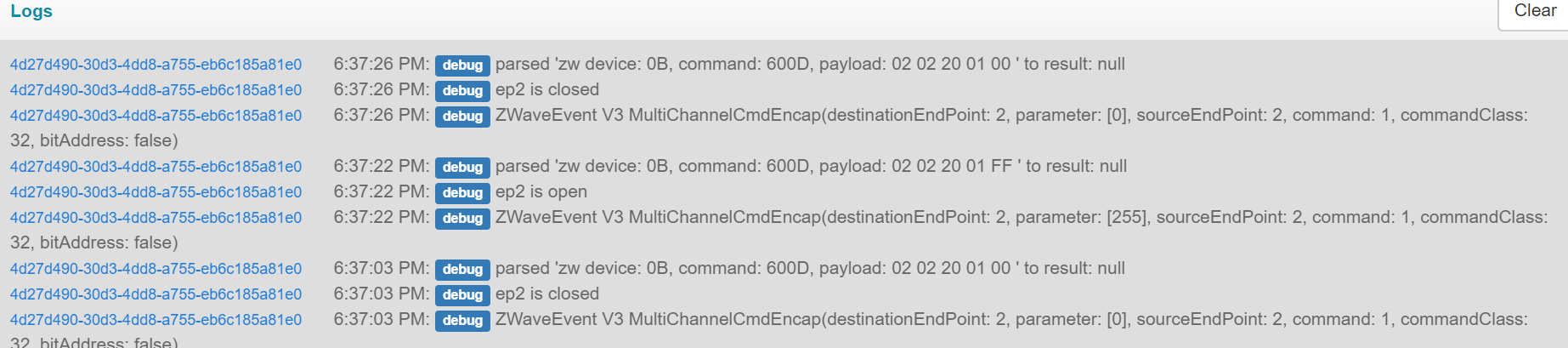

Hi there . just started using you great DTH. When i change to a motion sensor from a contact sensor the motion sensor symbol does not change but it shows in the mobile app (classic) that there is movement. Is it not updating the symbol ? Cheers again.
Are you taking about the child devices or the parent device handler one? The children ones update fine for me
The children one. endpoint 2. works until i change it to a simulated motion sensor then it wont work
bottom one is the log of the parent device . top log of the simulated sensor
Found out the problem . Changed some of the code hereâŚ

This line does not set the state to active /inactive for the motion sensor to change.
def motionstate = (currentstate==âclosedâ) ? âactiveâ : âinactiveâ
@vasarbob Can you paste the code with âcodeâ tags (in the screen where you type your message), since that way I can follow what you have changed and where.

Curious, right you are. I had made some changes in my ST device handler, but had not pushed them to github. Sorry about that and good spot!
Updated code on Github now.
