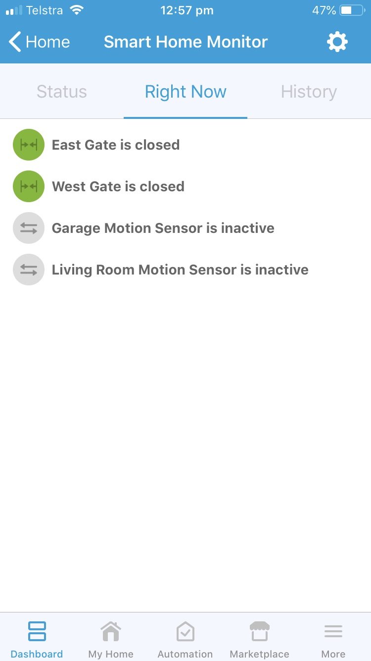

Hey Guys,
I’ve setup a UBS and each port is being used as a motion sensor (attached to a PIR for each).
They are correctly detecting motion when i view the device but when i check them in smart home monitor they are showing up as inactive and aren’t registering motion.
any suggestions on what i could of done wrong? parameters perhaps?
