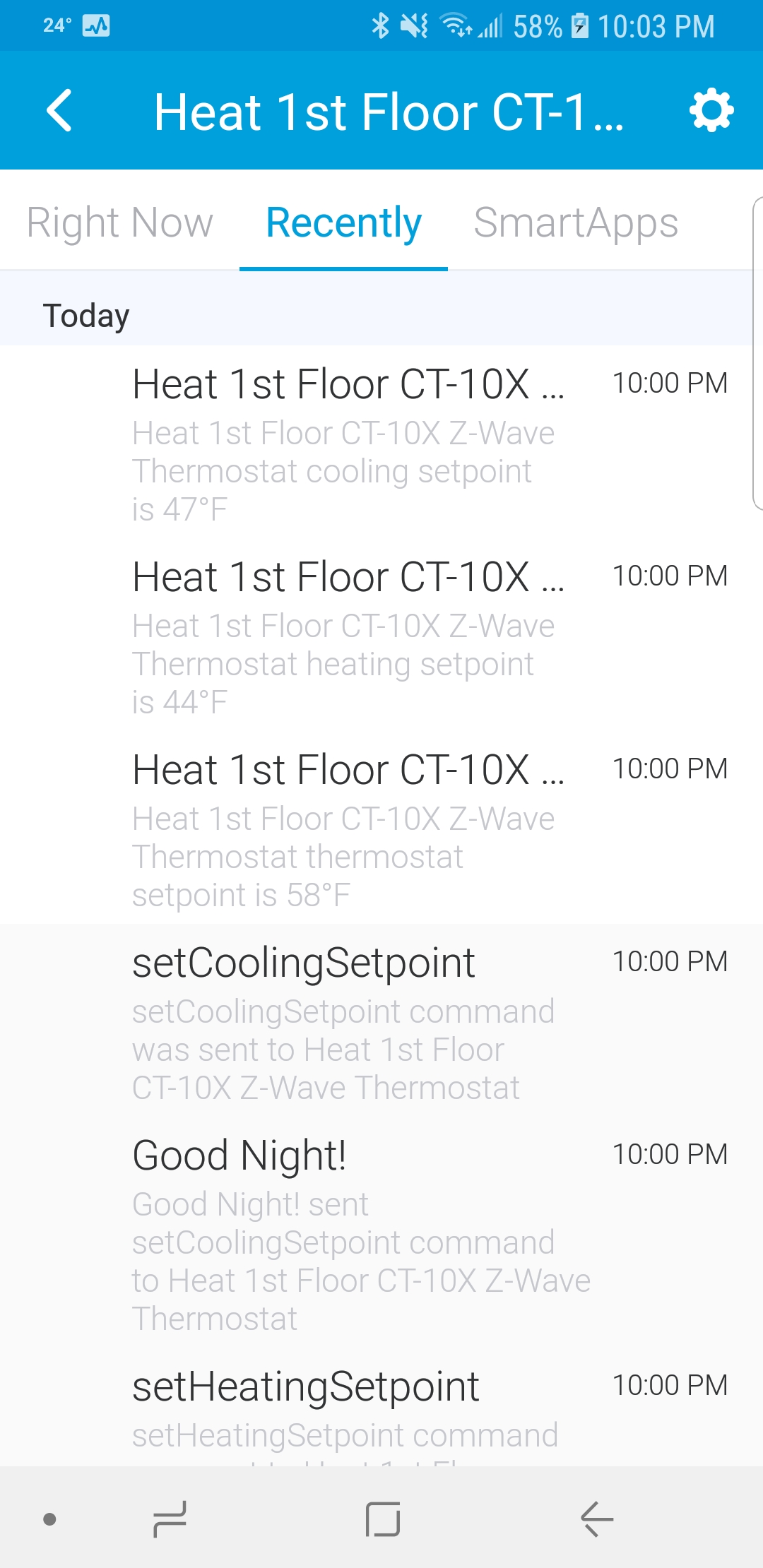

I have 2 CT-101 thermostats that is using the COOL settings for Heat. The changes I made to resolve this is Device type: Enhanced Z-Wave Plus Thermostat with Temperature, Humidity and Auto Time setting and CT100(suggested by ST support).
I have removed/excluded the thermostats,restarted the hub; I have used the reset for the thermostats- I have also tried different apps to manage the thermostat daily settings:the 5-2 thermostat with remote, Individual Change thermostat.

Can you elaborate on this a little. How did you figure that it’s using the cool settings for heat? Screenshots of the thermostat or the device page would be helpful too
You appear to be running into the deadband issue. Look like you’re using a custom device handler. If this based off the stock st device handler it has inherited the same issue. The device handler will enforce a 3 degree separation between the heat and cool setpoints. So when your SmartApp send 44 for heat the device handler is likely setting 47 for
Cool (which your recently logs also appear to show).

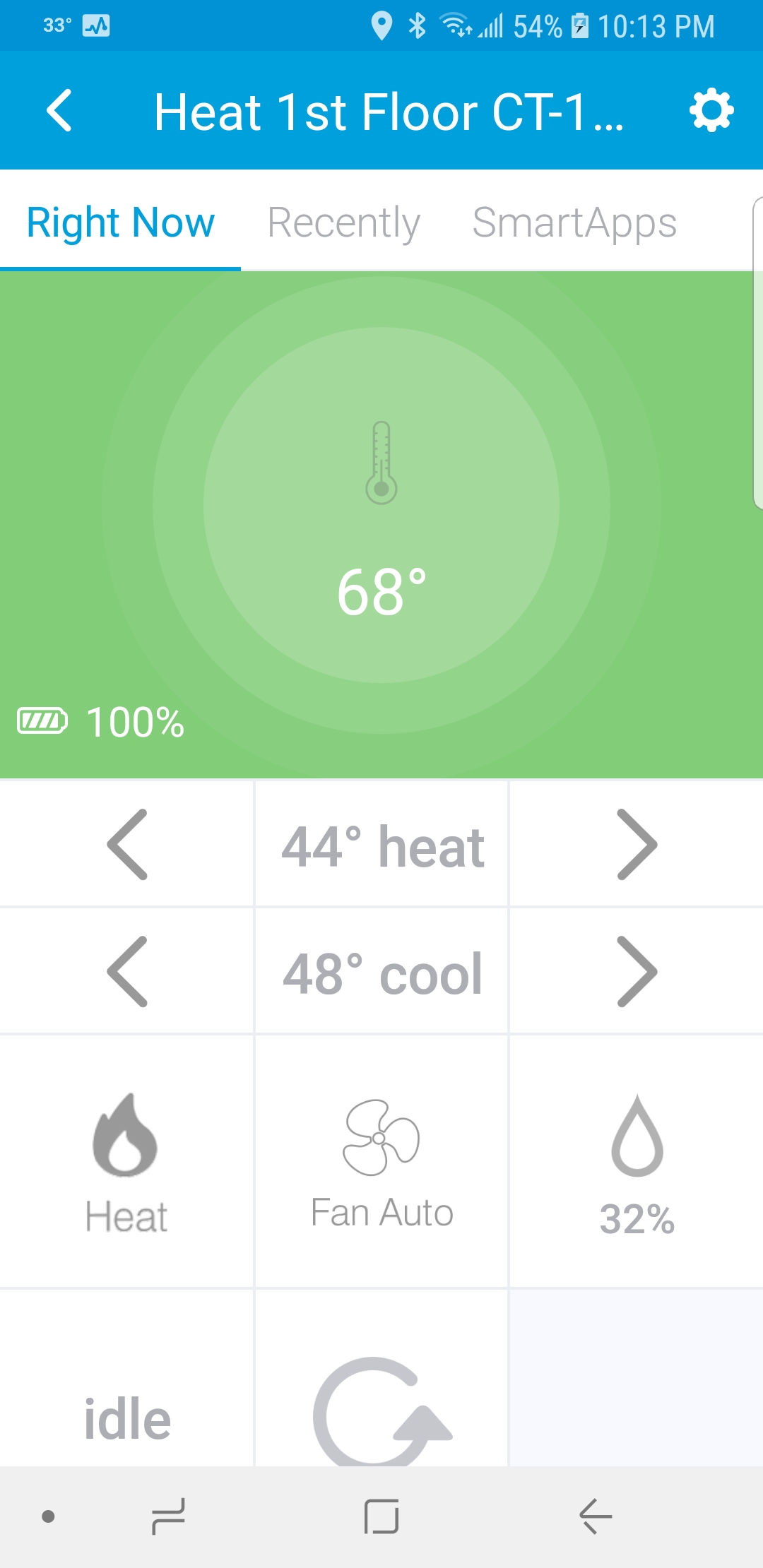

The Cool temp was set to 44 in the app and the Heat temp was set to 65 in the app. When the app ran on schedule, the heat setpoint was 44 degrees as you see in the attached, which was the Cool setting. Sorry, I dont see the 3 degree difference from the 44 and the 65. This was while using the 5-2 thermostat app. I did a search ‘deadband’ issue and find: _Supports synchronizing SmartThings dead-band settings with thermostat- I see this is associated with the DH-Enhanced Z-Wave Plus Thermostat with Temperature, Humidity and Auto Time setting. I’ll update the thermostats and see if that corrects the deadband issue you mention. Thanks
Same issue. As per new ST device handler the heat setting cannot be greater than the cool setting since this tends to “confuse” some thermostats. The deadband code also enforces this sanity check.
Thanks for the update RBoy-This is what I have done since- I removed all the thermostat apps, and set the DH to the _Enhanced Z-Wave Plus Thermostat with Temperature, Humidity and Auto Time (Ver 4.0) . I set a schedule to autoset the heat to 67 Cool to 66, DeadBand setting is 3. Attached are the screen shots that show the notification was sent on time, but no change to the thermostat setting. Any idea what I am doing wrong? Thank you
As I mentioned earlier the heat setting cannot be greater than cool settings. The deadband settings only works for thermostats that support deadband, the CT-xx doesn’t support deadband configuration, so the default is 1 degree is enforced by the device handler.
