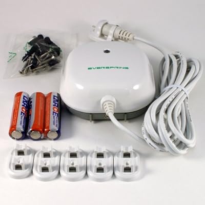

I tend to think there will be too much moisture between the contacts. It is rather sensitive, but effective.
Be aware the unit is not water proof. I use it in my water softener brine tank to trigger an alarm when the salt level is too low. It has triggered two alarms so far but each time it quickly filled with water. Surprisingly, it still survives.
I’ve used it other places but luckily hasn’t been tested in real life yet (no leaks or floods).
The Fibaro moisture sensor may be a better solution when it comes out. It claims to be water proof and configurable:
Thanks. I figured I could stretch a condom or something over it, leaving just the contacts on the bottom. But if you think it will take too long to dry out, perhaps it is worth waiting for the one you suggest.
I definitely think the key is to have contacts on a wire probe. That allows for instant wet and dry results. I use one to help notify me that a pump is working properly by having the water level go down to a certain level. The wire contacts allow you to mount it at a particular height to measure an actual level.

I personally think that with the two exposed contacts, it recognizes a dry condition much faster. It also allows you to mount the box more out of the way and not necessarily in the direct line of the water spray.

I have the Lowes branded version of the everspring. It is crazy sensitive! Probably would have the same evaporative problem.
