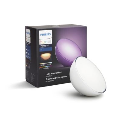

I came across the Philips Hue Go (with a Hue Bridge):
My idea is;
When everything is closed (all sensors made) and it’s night time (system considered armed) it has a very dim Green glow, “system is good”
If a door opens when the system is “armed” it turns red.
If a door is open during the day and we are home (system unarmed) it glows yellow.
So by quickly looking at it, if it’s red I need to find the door/window and close it,
green is good
yellow is something is open but it’s while we are home and the system is unarmed.
Is this possible?
I can research online how do do it. I just don’t want to go on a wild goose chase if it’s beyond the limitations of SmartThings/Philips Hue.
Thanks,

Definitely possible, but the go is big, and I think it would be distracting. We have one, and we use it as a holiday light.
We do pretty much exactly what you suggest and have different colors as different indicators, but we don’t use the Hue go for that – – we just use a light strip. We find it less distracting, but still easy to see an instant status.
I’ve mentioned before that we have one in my housemates room under his television. When I open the front gate it turns blue, and that way if it’s been blue for too long, he knows to come check and see if I got stuck or something (I’m in a wheelchair). We tried using texts but when he’s playing video games, he doesn’t check his phone. But he will, at least eventually, notice if the light has stayed blue. We also have it turn orange on trash day, green for when the mail has arrived, a couple of other things. It works really well for us and it’s definitely easy to do from the automation side. :sunglasses:
There’s also a smart light switch you can get which has colored indicator tiny lights to be used for statuses. A lot of people like that one, although then you’re talking little teeny tiny pinpoints.
choice is good: if you want an indicator light the size of a grapefruit, the go should work just fine. :sunglasses:. I know there are some community members to use it in a little kid ‘s room so the kid knows when they are allowed to get up in the morning.
I forgot to say if you like the idea of the go because it’s battery operated, be aware that it’s not intended to run on batteries all the time. It’s supposed to be mostly plugged in, but when you unplug it, the battery will last for 2 to 3 hours. It’s really just intended as a party light or, like I use it, as a jack-o’-lantern. You can’t have it on battery all the time: it literally shuts itself off after a couple of hours.

Ya it is a bit bigger than I’d like. Something around the size of a baseball would be perfect but couldn’t find anything like that.
The Go seemed to look good as a “central hub” for my house status.

It will be running plugged in all the time.

Thanks for the suggestion. I ordered a Go so if I don’t like the size of it I’ll check these ones out.
It’s a huge half moon as @JDRoberts mentioned. :wink:

Doesn’t seem that useful as its battery operated and you need to keep it charged. I am getting a couple of these for same purpose.

The go light also plugs in, it just has the option to run on its own batteries for about two hours at a time, but you can leave it plugged in 24/7 if you want.

Thanks for the info Ron. I did see that one when I was looking at indicators but ended up going with the Go.
It looks more like a “glowing object” than a light. Have it all setup and it’s perfect for what I want.
